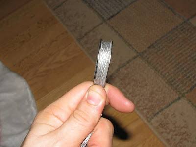

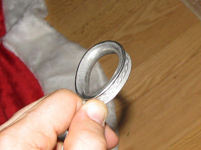

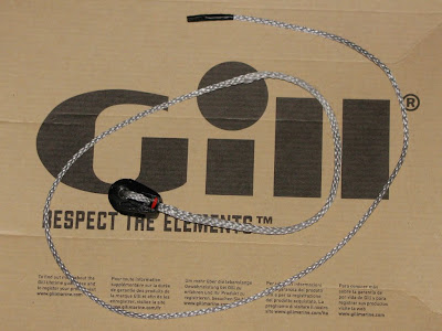

Watching TV last night, making this:
http://lh6.ggpht.com/_PPRkiYPDA_Q/SzuMfd69CtI/AAAAAAAAC-E/E0Lk0UPXHbM/s400/Sailing%20Stuff%20Christmas%202009%20019.JPG
I noticed that two 2.75mm dyneema lines fit really well inside of a 1/4" thimble. It's too cold to go test fit it with the shackle but it still looks like it would work. I think the thimble itself would protect the lines from chafe, as long as they didn't rub themselves to death. Either way, an oversized thimble may make this work.
