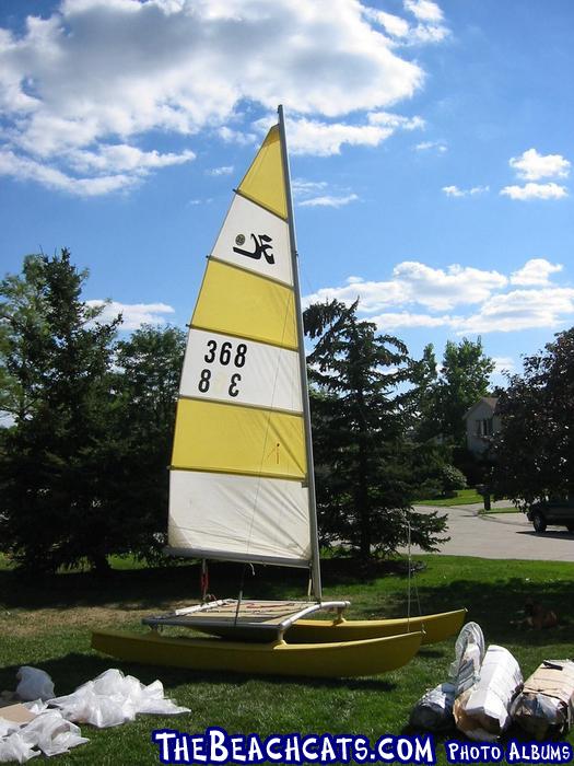

Anyone have a Hobie 3.5 they have in working order? I got one for 75 buck minus the boom and whatever was attached to it. Can onyone tell me what boom profile it is and whether the sail is supposed to have a loose foot or not? Maybe some nice close up pics? icon_biggrin

I have a 3.5 in working order. I don't have spare parts, but do have a pdf of the original manual if that would be helpful. I can also take pictures. What is the hull number of your boat? (I'm curious how many were made. Coast won't or can't tell me. Mine are hulls 11 and 117)
tom_gwynnI have a 3.5 in working order. I don't have spare parts, but do have a pdf of the original manual if that would be helpful. I can also take pictures. What is the hull number of your boat? (I'm curious how many were made. Coast won't or can't tell me. Mine are hulls 11 and 117)
Tom,
It would be great if you could take detailed construction and rigging pictures of your 3.5 and create an album for them in the Hobie 3.5 identification album here.
http://www.thebeachcats.c…ictures/?g2_itemId=61801
and please email me the PDF of the assembly manual to damon at TheBeachcats dot com as well.
Help me too!! Got a 3.5 as a project for grandkids. (even though their dad sails a Nacra).. Mine has wood rudders .. Is that stock?? Mast and base look OK.. Going to check the sail tomorrow to see if there is a boom in it.. Love to have a PDF on it.. Hoping someone can make a new tramp..

OK OK Could not wait till tomorrow to check her out..
I am lucky.. My cat is ALMOST whole!! Got rigging...mast and base (Looks like a prindle or sol cat with a stud drilled in the center of the plastic ball setup)..Sail, boom with blocks (Olde seaway like 14s and 16s).. Orig rudders I think which are fixable.. Linkage and tiller( spray painted black..) How do you renew old annodized aluminuim..(spl??) Needs a tramp but have the old one for a pattern.. AND the top of the mast whatever. It has a verry small pulley which would not stand any downhaul pressure... But this was not a racer.. But Hobie A. never built anything that was not sound.. Love to have a Pix of the mast cap/sheeve or what ever.. G-Kids can hardly wait.. Next summer Cheers Hal
