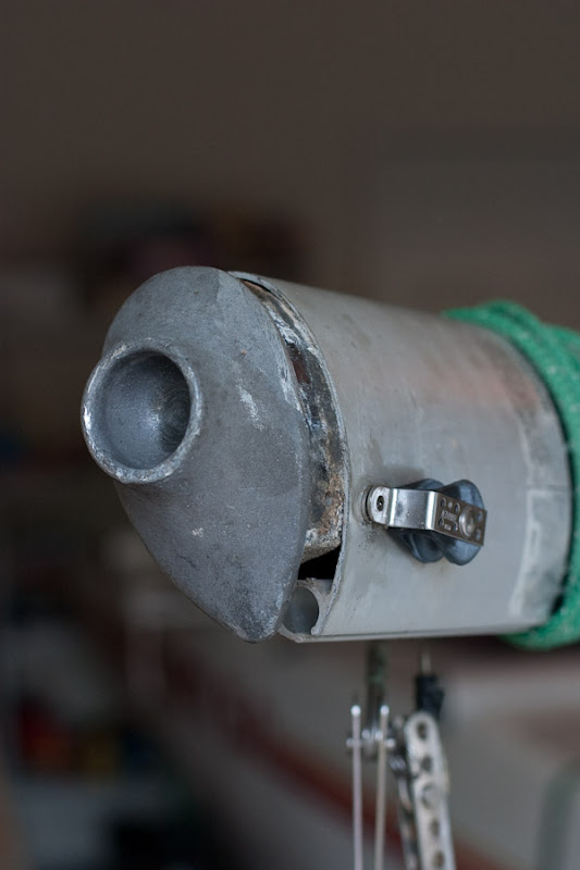

A couple more questions. I was reading the nacra assembly manual, and it says the main sail is hosted and then hooked up on a hook to the top of the mast (like my Hobbie 18 was).
I was working on the boat today, and it looks like I just hook the shackle to the top of the main, raise it to the top, and then just tie the main raising line a clear to the bottom of the mast. There is no hook at the top of the mast? Is this normal? The nacra manual says there should be. This is a 1983 Nacra, per the hull.
Second, the mast sits on top of a ball as per the manual. However, the mast seems to sit high up on this ball, and is not cut out on onside like it says in the manual.
Is this a aftermarket mast or something?

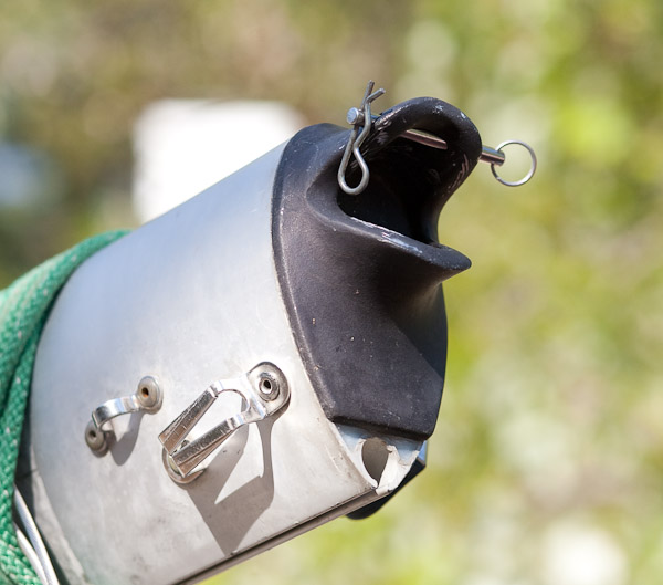

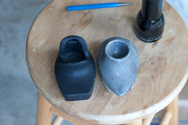

You have an '83 model, it should be the same as my '84. There should be a 1/4" "ball" swaged onto the wire halyard. You should be able to see it about 3-4' from where the wire halyard attaches to the line portion of the halyard. When raising the sail this ball travels through the sheaves at the mast top, & comes domw the FRONT side of the mast about 3'. There is a small fork riveted to the mast. Pull the halyard til you hear it "click" & it won't pull any further, this means the sail is all the way up. As you give it that last few inches of travel, hold the halyard 1-2' in front of the mast. this allows the swaged ball to clear the fork. Now move your hand right up against the mast, keeping the halyard exactly in line with the center of the mast, & release some pressure. The ball should engage UNDER the fork & lock the sail. It really is very easy, & once you've done it, you get it every time. If it doesn't hook, something is binding the sail & it isn't all the way up. You may have to rotate the mast so you can keep the line at the center of the mast.
The mast steps were made in 1 1/4" and 1 1/2" sizes. I think your .83 uses the smaller ball, & they don't sell them anymore. I can post a photo to show how the step should sit on the ball if you need it.
The fix is to replace the mast base,(Murrays has a kit to changeover) or go to an industrial supply company,buy a bag of 20 delrin 1 1/4" balls, drill & tap them to 9/16" fine thread, & sell the others to guys with older style bases.

Here is a photo of what my mast step looks like. The bolt,(or 1/4" pin) for stepping the mast is in place. If you do not have the captive ball system, you may not have the bolt/pin. It makes for a much more secure arrangement as the mast is going up or down. The wishbone is the mast rotator on a boomless nacra.

The bottom of my mast looks like yours in the pic, except it doesn't have the sides cut out, or any holes for pins. Likewise, the ball looks larger than that, and doesn't sit anywhere near that far in the hole. About half the ball is captured under the bottom of that necked part of the boom. I forgot to take a picture, but I will tonight. I am a bit worried, because I think if I were to capsized right now, the bottom of the mast would popped off the ball. The previous owner said he turtled it before, and never said he had that issue? I'll take a picture tonight, or soon.

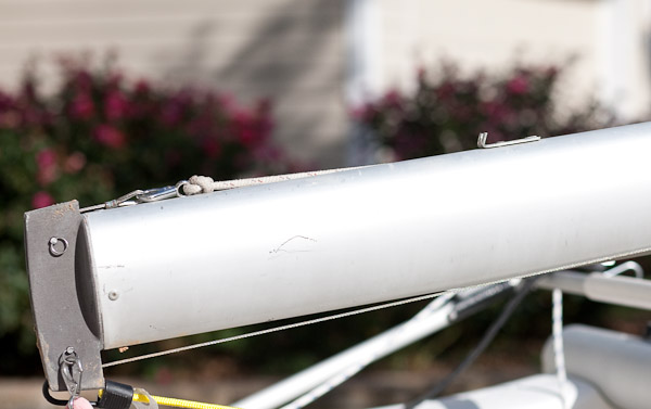

Also, my Nacra is missing the wishbone on the front of the mast, and noticed the mast is rotating like crazy. Basically it follows the sail. This is slowing me down I'm sure, but then again my Nacra doesn't have the cleats like yours does on the front cross member to mount the lines to. Should it have one?

EC's mast base looks like the old style 1.25" and will have to be replaced when the ball finally kicks it. Sounds like yours is an even earlier one than that. I would suggest drilling a 1/4" hole in the front part of the casting for a pin during stepping. It has to go immediately under where the ball sits just to keep it from dropping under off of the
Normally you don't leave the pin in once you have stepped the mast. The shrouds and forestay keep enough tension on it that it shouldn't jump off the ball when you capsize. If it does then your shrouds aren't tight enough. The should be tightened to the hole on the adjusters that you can reach with one person hanging on the shroud and one person putting the pin in (between 150-200 lbs of pressure or thereabouts). That should give you enough tension to keep the mast in place but still allow it to rotate freely.
I believe you can get the wishbone from Murray's Marine and the cleats are just standard and are mounted to the front beam.
The wishbone is a mast rotation device, it was optional on the boomless models. Murrays sells the part, $39
http://www.murrays.com/mm5/graphics/00000001/25-304.jpg
You may be able to find a used one from a parts boat, email Dan berger, he usually has lots of stuff for sale in the classified section, & is a good guy to work with. You can also ask for the cleats to mount to the front beam.
Nacra says on boomless boat the rotator is to induce rotation. I've never raced, so I'm not knowledgeable about getting every last speck of speed, but the rotation certainly does help. If you ever forget about it & have it on the wrong side, you suddenly find yourself flat on the water when all your instincts say you should be flying. The photo above is old, I don't have it rigged like that, one of the guys here,(Philip, or Ron B?)told me to tie a line to the eye strap on the beam,(just inside the cleats)then out to the end of the rotator, then back through the cleat. This gives a 2:1, & you need it. I was surprised how much force there is trying to turn the mast. In very light air I cleat both sides, it prevents the mast from banging to & fro & shaking the wind out of the sail.
