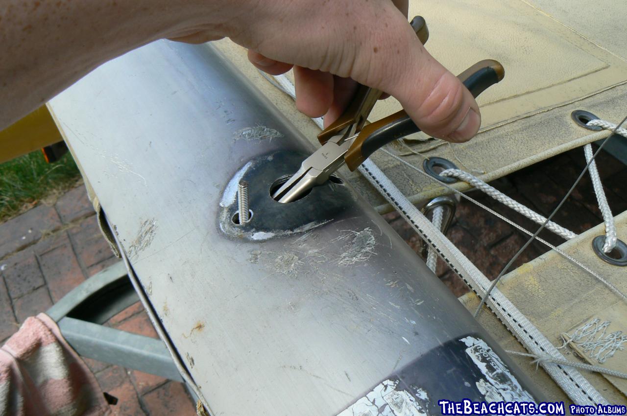

You will also notice i have already repaired the cast aluminum base. That broke when someone put the trailer winch on the dolphin striker.

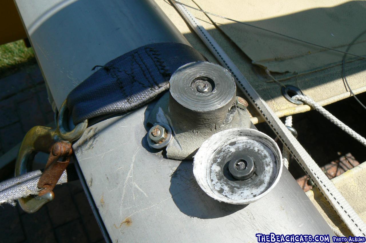

http://www.thebeachcats.com/gallery2/main.php?g2_view=core.DownloadItem&g2_itemId=81038&g2_serialNumber=3

Great job on getting the picture posted!
That mast base looks nasty.

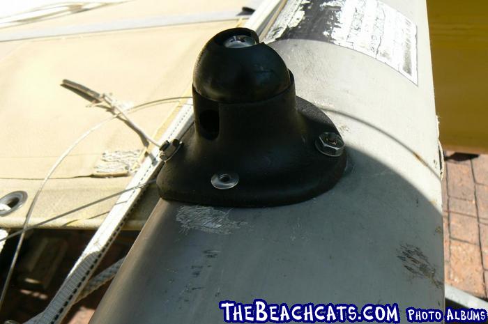

http://www.thebeachcats.c…ictures/?g2_itemId=10984
I got my replacement assembly today. Same design 4 rivets, but all black. now front and read holes are matched up. How did yours not match up?
Nacra 6.0 NA
Ogden Dunes, IN
That was not my photo album, but on mine when I went from the two rivet base to the 4 rivet one, I had to drill 4 new holes. I think they did it that way so when the old base gets loose and wallows out the rivet holes you can start with 4 fresh holes. Looks like to are going to need huge rivets in the holes where you have bolts.
pk, on second glance the front holes match up but the rear misses the hole by half a millimeter. i might try it and ill probably have to end up putting a bolt in the front hole again. i just wonder about the stainless steel rivets they gave me those are gonna be tough to crimp first of all and i question if they will be too long for a 1/4 in of the mast base and another 1/8 in of cross bar. Ill upload pictures tomorrow and if you can tell me if they look to the the same that would be great.

http://www.thebeachcats.com/gallery2/main.php?g2_view=core.DownloadItem&g2_itemId=81052&g2_serialNumber=4
These are the rivets that came with, but are they too long? I'd hate to squeeze down on one to find out it's still loose.

That looks normal to me, the long part is the part the rivet tool pulls on and breaks off.
I know I was suspecting the thicker unseen part may not pull all the way to the cross bar. I'll give it a try though.

They look correct to me as well. Mariner has a rivet chart on their hobie parts pages. They will be tough to
pull, but with a good rivet gun you can do it.
As I'm using two bolts for extra strength I practiced with one of the rivets and it pull well thanks.

Do you mean you are using bolts like were on your old one, like your picture?
How did you get to the other end of the bolt?
Stainless rivets are really strong and four of them... But maybe the holes in your beam are rounded out too big for rivets?

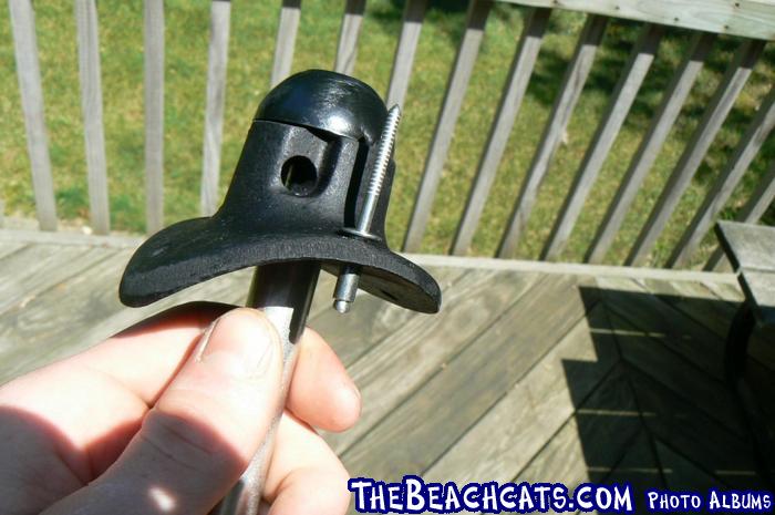

http://www.thebeachcats.com/gallery2/main.php?g2_view=core.DownloadItem&g2_itemId=81139&g2_serialNumber=3
http://www.thebeachcats.com/gallery2/main.php?g2_view=core.DownloadItem&g2_itemId=81135&g2_serialNumber=4
There you have it. The bearing you can see is broken it came in the mail that way. Courtesy of sailsport marine.

Call Sailsport Marine and have them replace that bearing or else........ headshot

You just wanted to use that smiley didn't you?? I called them and sent them an email of the bearing.

What do you have to do to a tough plastic dome to break a chunk off? That's weird.

I don't know how they broke it. but I took it sailing for an hour yesterday in, honest to God, 6 foot rollers and now its destroyed. pengpeng
