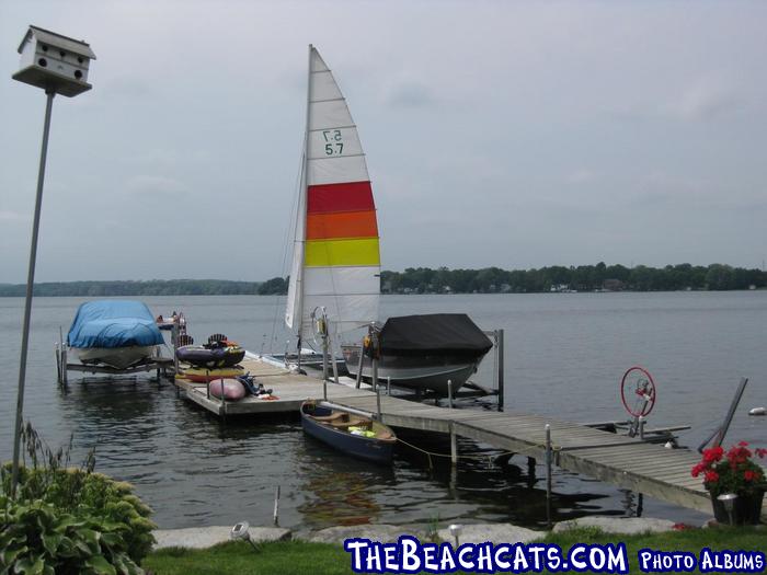

I used to loop a line from the dock around the left bridle wire, and another around the end of the rear beam, lots of room to run it between the beam & tramp. I've since made up two permanent docklines, with a stainless steel clip on the end. This makes it very quick to clip onto the bridle wire, & the end tramp lace, or a loop I have fashioned onto the edge of the rear beam. These clips are only rated at around 250 lbs, so use them with care. I think GCAMICK uses the same clip arrangement.
With the wind we get 90* of the time, the boat is pushed against the dock. If the wind was strong, the jib was a royal pain. Roller furling made the jib a non issue. If the wind is right on the beam, it can be a little troublesome to raise the main solo, an extra set of hands helps keep it from fouling the ends of the battens on the shrouds. Also, even with the mainsheet undone, the sail against the shrouds develops some power. You need everything organized, because as soon as you cast off the last line you will be moving forward. Use care pushing off, so you don't ding the corner of the boat or rudder against the metal corner of the dock. If you always have crew, it is easy to walk the boat into the wind, as Pete says, then raise the main.
Coming back in, with strong winds, roller furling has turned a somewhat hairy event into a no brainer.
Even solo, with the jib furled, it is easy to head up, unhook the "S" hook from the clew of the main, jump off, grab the bow so you can hold it head to the wind, then walk it back to the dock, reclip the two lines, then leisurely drop the main & de rig or whatever you need to do. Of course my method would need modification if the water at the dock is more than chest deep.
http://www.thebeachcats.com/gallery2/main.php?g2_view=core.DownloadItem&g2_itemId=75954&g2_serialNumber=4
