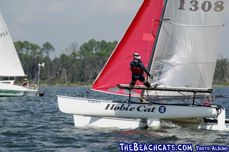

I solo my Hobie 18 more than I have crew, even during races. I can right the boat without poles or buckets but of course I'm a little larger than average. However, technique is everything and I know someone who probably weighs 100 pounds less than I do who also solos the H18 and can right it (as they need to quite often icon_lol )
If I was lighter I could show off like this instead of just staying planted sitting on the wings.
http://www.thebeachcats.com/gallery2/main.php?g2_view=core.DownloadItem&g2_itemId=72074&g2_serialNumber=3
Instead I don't even rig the trap wires on my boat.

QuoteIf I was lighter I could show off like this instead of just staying planted sitting on the wings.
that stinks. Put a spin on that thang! you can fly a wing or do the wild thing under a chute
In good air i have double trapped off a very overweight mystere 6.0 ... 2 on the wire, skipper still sitting on the wing. in 25+,., it was / is a hoot.. i hope i get to do it again this fall.
i did personally take my crew trap rig off because its rare to need (or ability) to double trap and the damn thing gets caught in the jib and spin..
fall is around the corner (wind here) so i may put it back on
