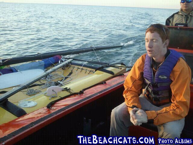

Saturday I was sailing 4 miles off shore on Lake Michigan. When something like this happened...
http://i150.photobucket.com/albums/s86/Suanjammers/Photo85.jpg
For those of you not familiar with the great lakes, they are cold and deserted. We had just turned back to shore when there was a bang. We were blowing out to sea fast. Thank God we brought a Cell phone.
http://www.thebeachcats.com/gallery2/main.php?g2_view=core.DownloadItem&g2_itemId=82246&g2_serialNumber=3
Some of us don't have the luxury of sailing with other cats, So I urge all of you to check your anchor pins, bring a phone, and tell someone where you'll be and when you'll expect to be back.

To the OP, off topic but why is your tramp so loose?
Greenville SC
funny what people notice in a picture. i noticed the striking resemblence of the sailor to a popsickle!...and that look you get when the mast decides to come and join you. the first time i met matt922, i was loading my boat at the secret spot and there he was with his boat-horizontal mast and that same look on his face...i must have had the same look when i heard that loud "BANG!". a picture is worth a thousand words, i nominate this one for "best demasting photograph", it has it all- the rescue boat, the crippled cat, the frozen/demoralized captain...you should submit this one to life magazines "the beachcats edition"!
QuoteTo the OP, off topic but why is your tramp so loose?
It's not. It may look like it is sagging but that's just because the cross bars are so high above the trampoline sleeve on the hull.
Quotei nominate this one for "best demasting photograph"
I tried to find a picture of what a demasted Hobie looks like with the sail still up and all, to show my land dwelling friends, but my search came up empty.
