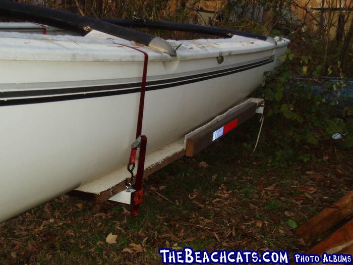

~~ I did this for my 17 & 18 after the snow crushed my 17 hull......(lets see if I can do this right) http://www.thebeachcats.com/gallery2/main.php?g2_view=core.DownloadItem&g2_itemId=60644&g2_serialNumber=5
and other toys.......
Bernhards Bay. ~~~~~~
~~~~~~ 2x10x10 with 2x4 on the sides..... use carriage bolts on the 2x10's through the frame supports, & an old piece of carpet~~~~~
