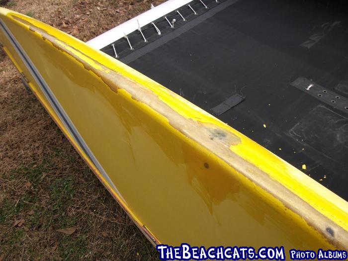

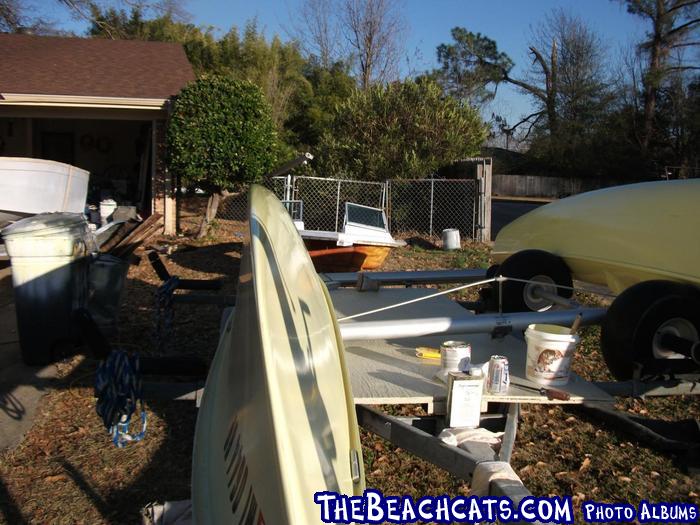

Thickened Epoxy is the way to go. Turn it upside down, use some duct tape to build a well down the middle, then pour in, let dry, be happy for years!
http://www.thebeachcats.com/gallery2/main.php?g2_view=core.DownloadItem&g2_itemId=79178&g2_
if you want to go all the way, hit a layer or two of glass along the keel, sand and fair, then put a fat coat or two or three of gelcoat...nice offseason project.
http://www.thebeachcats.com/gallery2/main.php?g2_view=core.DownloadItem&g2_itemId=79215&g2_serialNumber=4
http://www.thebeachcats.com/gallery2/main.php?g2_view=core.DownloadItem&g2_itemId=79223&g2
i painted mine because they were painted, but since yours are gelcoated you can stick with that...you won't regret doing it right!

get a quart of gelcoat...sand it back a little, put on a few coats, sand smooth...some labor no matter what product. and if you take a minute , you can match the gelcoat pretty close.

http://www.thebeachcats.com/gallery2/main.php?g2_view=core.DownloadItem&g2_itemId=72656&g2
this is what i was working with...paper thin at spots, holes at the other spots...rock hard now!

My keels still look good from the outside. If you don't look through the ports you would never guess the gelcoat was thin. I see now why you added glass mat. I would too in that case. Funny thing, the thin gelcoat lets you see the glass mat pretty well. Looks good so I will stick to building up the bottom 1". I figure it might take two of the small kits this time and one every 1-2 years thereafter.
