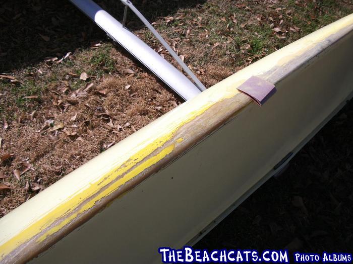

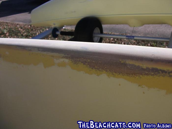

I just purchased my first catamaran, a Nacra 5.2, and took it out for the first time last weekend. Unfortunately I found out that the hulls leak a lot more than what the seller indicated. I thought he was a decent guy, and told me they leaked only "a few cups." Unfortunately its really more like gallons. When I put the boat on the trailer and cinched down the ratcheting straps, I could see that this caused water to leak out the bottom of the hulls right by the front crossbar. It seems that its coming from the seam where the two fiberglass pieces are molded together.
Today I took the hull off, turned it over, and sanded off the gelcoat on the bottom where the seam is. I filled a bit of water in the hulls and found a fine crack where water seems to seep out of. Its just right near the seam. I took several pictures of this, but it is difficult to see the water coming out. I can see on the inside of the hull that one of the previous owners has laid down some fiberglass on the inside of the hull where this crack is in order to fix it. Clearly that didn't do it.
I want to fix this, but I am not sure of what the right technique should be. Should I just try to fill in the crack with epoxy? Should I sand it down to be thinner and lay down some strips of glass on top and fair it with epoxy? Or should I completely cut this section out of the hull and try to lay down glass from the inside? The last option would be most difficult, as while there was an access port added where the damage is, there is also some extra glass and epoxy down there that makes a rough surface.

I hope the only problems I have with my hulls will be the upper decks. I am going to add some gel coat to the bottom edges because it shows the clear resin from being loaded and unloaded on a trailer (just an assumption as to the cause of the missing gel coat) I did fix a small fiberglass boat once by grinding out the cracked area to be able to get some epoxy with glass fibers into the place where the crack was. It held up for years but wasn't put to a lot of stress like the hulls on a catamaran might get.
Be careful with ratcheting straps, you can easily make a bad problem worse, or just create a new problem from the force of the straps.
IMO to do it somewhat right, you should pop that front deck off, and lay a pretty thick layer of epoxy/glass on the inside of your cleaned crack ^^. Then once it cures, flip the hull over and sand through the damaged area until you reach the patch, then rebuild w/ a little glass. Finally fair w/ the microballoon fairing compound.
Then find a new deck and put it back on w/ cabosil thickened epoxy. Your current deck's inspection port weakens the whole hull in a bad spot.

Hey. If strength and hull integrety is the issue you have one probem. If leaking is the the issue you have a differnet problem. To me the bottom looks like many years of dragging on the beach has caused leakage.. ALSO>> Perhaps too much pressure on the tie downs on rollers in transport may have stressed the seam at the keel.. The fix for me for a olde boat that still rocks (and the 5.2 does) is to seal the H2O leak from the inside ,, do a fix-it leak patch inside the hull( Add a bit more glass than necessary to that area .. fore and width) since you have access to the keel and after sealing the leak and add... some glass to the outside (if necceary) to prevent further damage if necessary.!! (Be carefull not to plug the drain holes from the front sections of the hull( see Chris177 here on the photos on the inter hull photos ( Chriss U rock??))) .. AND sail the Pis* out of her .. And Get or Make ( I will have a photo log of this on B Cats soon) on makin trailer guides/cradles so the hull are not on just rollers on the trailer but more surface area to ease the pressure on the keel on the trailer.. Don't get P**ed off, even to the guy U got it from. U will never regret it! U have a 5.2.. Enjoy the balance and the spirit and the "coolness" of a 20+ year olde boat that was WAY AHEAD OF IT"s TIME and still rocks.. Like living with the a lady love you never had.. she rocks!! Say By By to H 16s and 18s.. Horizon Time !! Cheers H

Looks like minor trailer damage and wear 'n tear to me.
I popped the lids off my bows last year using a small chisel, working round a bit at a time. The cracking sounds may freak you out but don't worry, a liitle epoxy goes a long way! Just open 'm up so you can get at the rough repair, grind her down quickly with one of those flapped sanding disks and wet out with the epoxy, add one layer of heavy glass, ( 4" Biaxial tape is truly excellent for this!) wet some more and wait. Mean time check for delam on the internal strengtheners and repair where neccessary, If there are any kinks in the stringers, fix and add a reinforcing tube there from side to side. Just wrap a cardboard roll in glass and epoxy it in place.
When it comes time to put the decks back on, clean em up and coat the edges in unthickened epoxy, which should soak into the cracks made with the chisel. Then glue in place while still runny with a moderately thickened batch. Heaven help the poor bugger who ever has to go in there again, but it'll be plenty strong for another couple of decades.
Some health tips: Clean up epoxy with vinegar, better for your health than most chemicals and actually works well. Don't sand green epoxy, let it cure. Then let it cure some more. Oh yes, using a highly efficient sanding disk on a grinder *may* p1ss off your neigbors, so watch out if the wind is blowing in the general direction of their new car. (Don't ask me how I know this)
Thanks for the advice halliske and dennis. Actually most of what you see was caused by me using my disc sander with an aggressive grade disc. I wanted to see what was actually going on with the fiberglass below.
Dennis, what I found actually was that someone had already done just what you suggested, which is why I found my boat has extra ports on the fore decks. And I'm the poor bugger that has to go in and fix it... what happened was that the glass they laid down did not bond to the hull completely on one side of the boat, leaving a less than watertight seal.
I just tried to break that glass away as best as I could, and I sawed a decent sized hole in the bottom. I'm laying down one layer of glass from the inside, but I'm then going to lay up another two sheets from the outside to bond to it. I tried to clean it up on the inside, but its tough to prepare a surface that has 30 years of crud on it, even after sanding and acetone. Hopefully that will give a better seal. I'll fair any rough edges with epoxy mixed with microballoons.
Its tough that the repair has to be right on the bottom edge though. I'll have to remove a fair amount of gelcoat to get my outisde glass to bond to the hull.
Remember that the hull has drain holes. Perhaps a pressure washer would help get the crud out. Especially if there is a bit of flow out the cracked seam... It might identify where the glass did not bond. Can you get a small hand held grinder in there?? Perhaps a Dremmell even.. For me, I would rather do more layers inside and have less to fair on the outside. Again, remember not to plug the drain holes near that keel.. Though not as serious, I am down to the glass on a small section of one hull on my 5.2. Might be easier and look cool to do a new layer of gelcote (colored??) like that cat that is forsail in the classifided.. Looks COOL Cheers H

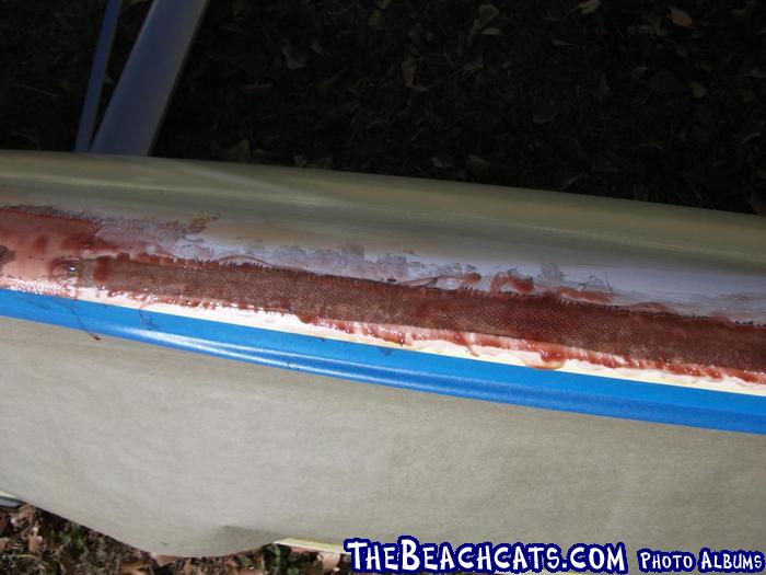

Well, I ended up laying down a single thin glass "wear strip" about 2 in wide right down the seam. Then I added epoxy with microspheres on top. It worked well on one hull, but the other one I let cure outside overnight and the dew totally screwed up the epoxy cure. It came out looking like orange rust dripping down the side of the boat. Time to get out the disc sander again. icon_frown
For future reference, I think it would have worked equally well to try to seal the cracks with thin epoxy, and then later apply a thickened epoxy layer right down the midline of the boat as a wear strip. What I've got seems watertight now, but we'll see how well it holds up to mechanical flexing and such.
With your wear strip, you're leaving uncoated epoxy and microspheres on the bottom? Or did you apply a layer of gel coat over it as well? I'm planning out a bottom job on my boat, too, so I'm fishing for ideas.

Also, I laid down a glass "wear strip" which serves the dual function of keeping the two molded halves of the nacra hull bonded together. I think other models of cats may be made differently and don't have the seam on the bottom. For better wear resistance I could have chosen kevlar, but I've heard that the epoxy doesn't sit as well in it. Also, I wanted to get the job done now and I didn't have time to wait for it.
I can say thought that this operation was much easier than I thought it would be. I tested the hulls by putting water in them and they seem to be watertight.
