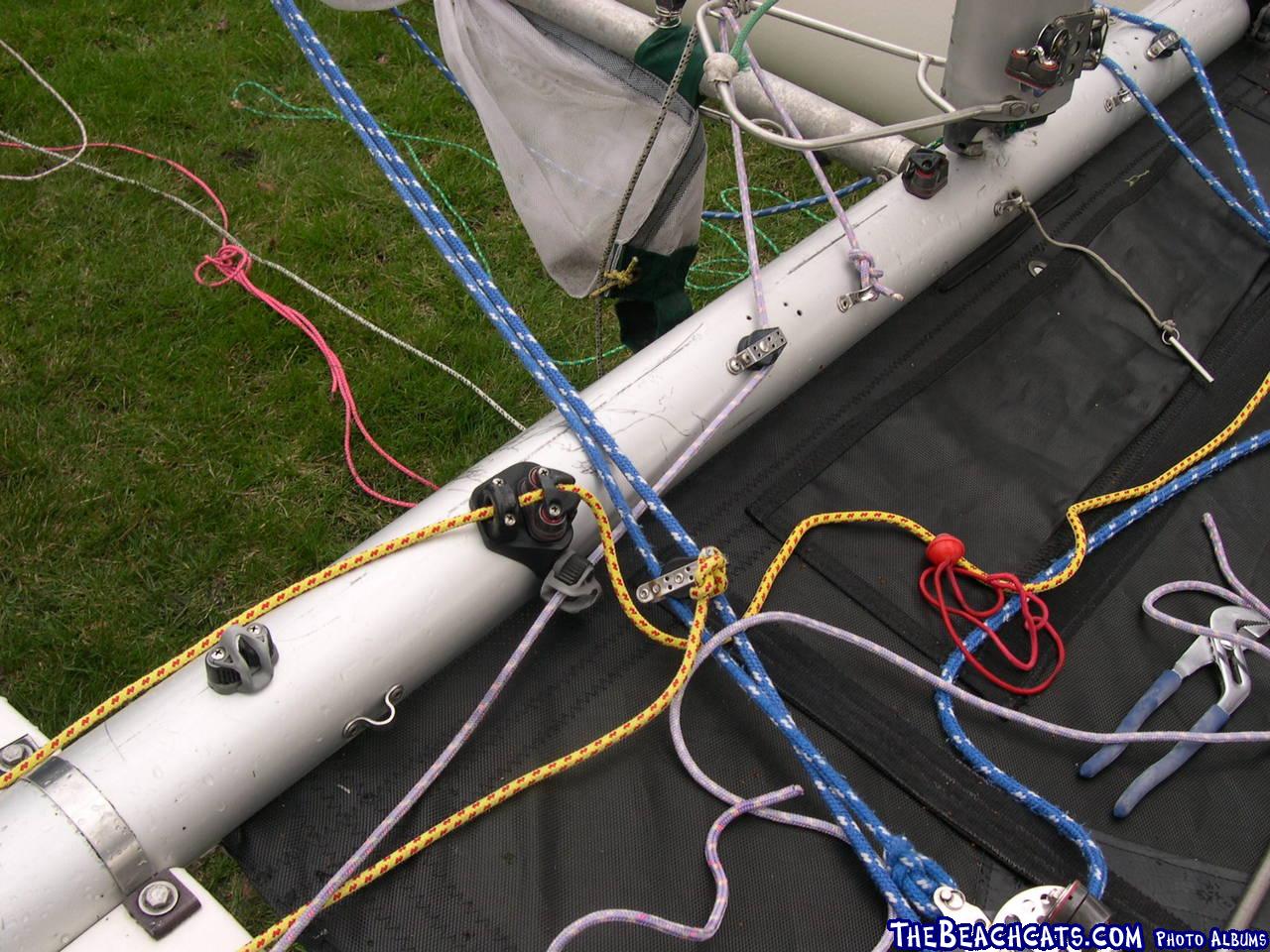

You definitely picked a boat with a lot of setup for a beginner. It's an awesome boat just a bit of high learning curve for rigging. A friend of mine has done some interesting modifications to his 5.8 that I want to document sometime if I remember.
Not a 5.8 but a 6.0 with barber hauler, and only one side of the rotater rigged. Your set up may be somewhat different, (turning blocks and cleats).
http://www.thebeachcats.com/gallery2/main.php?g2_view=core.DownloadItem&g2_itemId=59699&g2_serialNumber=4
Downhaul line is 3/16 and about 30 feet or shorten to taste, ends tie to the crew's trap dog bone.
Rotater line is either about 18 feet of 3/16 continuous or 2 pieces of 3/16 about 9 feet with the ends tied to the beam straps.
