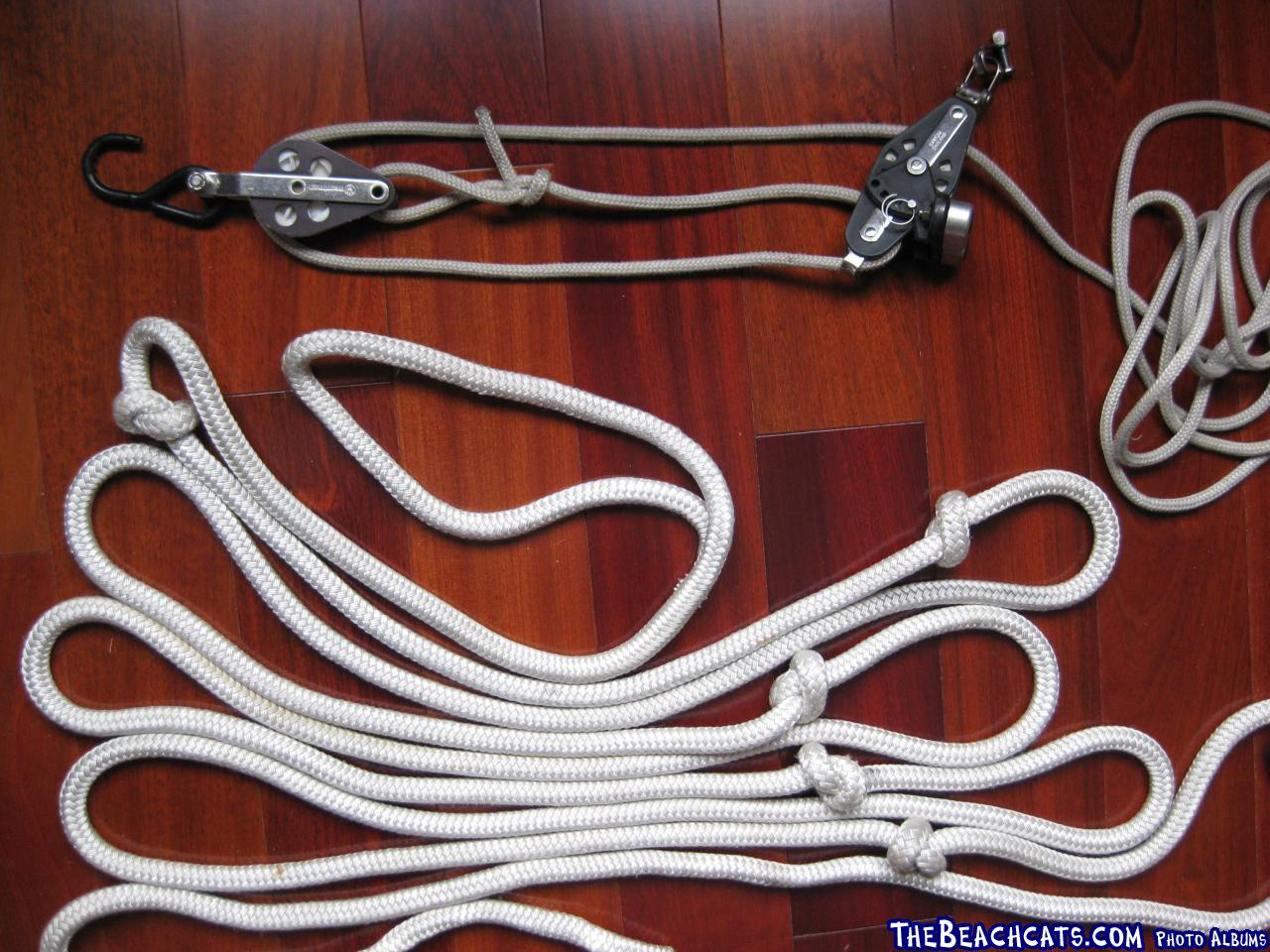

http://www.thebeachcats.com/gallery2/main.php?g2_view=core.DownloadItem&g2_itemId=74272&g2_serialNumber=3
I found a small 3:1 makes life much easier. The black "S" hook attaches to the bag, the shackle to a predetermined spot on the righting line. You need to experiment a bit, with the boat flipped on a calm day, to find where it needs to be attached, so it is in a usable position. Don't wait til all Hell breaks loose to try & figure out where to attach it.
Now, with the Cat flipped, toss the righting line over the upper hull,(either with the bag already attached, which is harder to do in a stiff wind, or toss just the line, then clip the bag to the loop or small piece of line at the spot on the righting line you have predetermined to work). Drop the bag into the water & fill. While standing on the hull, hoist it to the middle of your back & cleat. Step inside the line, so the bag is now against your back, grab the righting line with both hands & hike. Notice the knots in my line. They were also predetermined, so that you can go hand over hand til your body is horizontal. It is important to "plank" not pike. The further from the hull you get the mass, the greater the righting moment.
Two small but important details.
A) Secure the bag well, especially if it remains attached to the line. If it deploys at speed, well... icon_evil
B) Secure a 5' length of thin line to the BOTTOM outside of the bag. You will end up at some point drifting with a full bag, like a sea anchor. With the line, a child can collapse & retrieve it, without it, you will only do it once.
