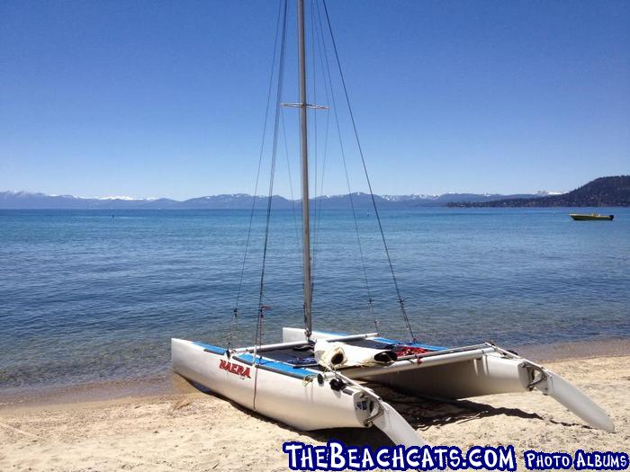

Well here is an update after sailing it for the first time last weekend for 4 days straight :)
"WHAT A GREAT CAT" is the overall impression and comments most of my buddies who sailed it with me said.
Love the practicality of the easy handling on the beach with no boards to worry about.
Can Jibe it all day long without a worry because of the boomless rig.
Accelerates very well and will power up on virtually no wind.
Very pitch pole resistant when driven hard.
Super clean trampoline unlike the P19.
