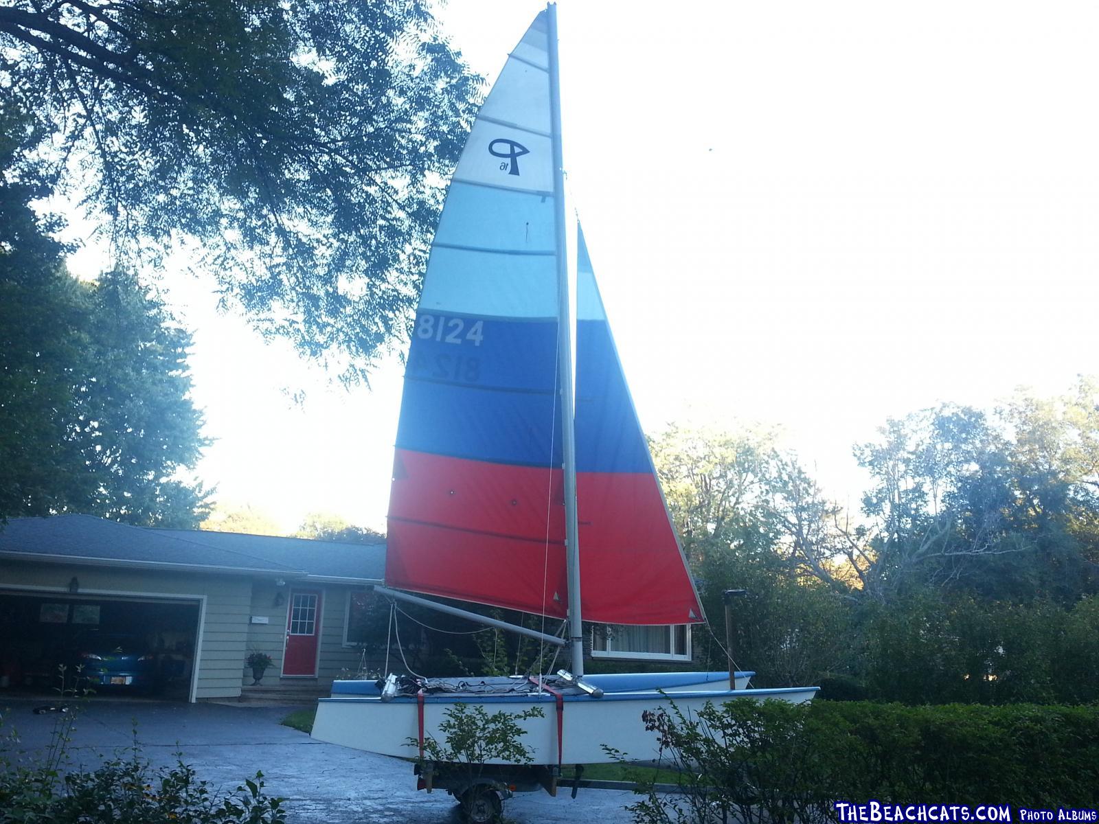

rwj0j0Post some pictures of your boat...
Here it is - still on the driveway though...
http://www.thebeachcats.com/gallery2/main.php?g2_view=core.DownloadItem&g2_itemId=105835&g2_serialNumber=31
Mike
Prindle 16
Rochester, NY
It is not going to sink.
Your boat looks great! Looks like she was hardly used - can't be sure without better pictures but there is very little wear
Take her for a sail!!!
Your trailer configuration however leaves a lot to be desired. You need to fix that.

rwj0j0It is not going to sink.
Oh, it was used enough to have a visibly uneven patch job on one of the hulls. It was painted over though, so it must be alright icon_razz
rwj0j0Your trailer configuration however leaves a lot to be desired. You need to fix that.
That's what I am working on right now. The previous owner - the one who never got around to putting it in the water - built the trailer himself. He used 2x6 lumber for the frame, which makes the cat sit at least 4" higher than it needs to - I plan to remedy that with some steel frame tubing at the first opportunity.
That's not the biggest problem though - the mast mounting hardware did not survive the 5 mile delivery from his driveway to mine. He used a Hobie Mast Caddie split into two. The top part of the Mast Caddie (the mast clamp) was mounted on top of a 2x3 piece of lumber that cracked when I tried to remove the mast from it. The bottom part of the Mast Caddie (the rear crossbar clamp) was fashioned with some loose wood pieces in a way that endeavored to clamp the mast to the crossmember directly. That mound fell apart in transit, so now the mast has some minor dents in it (at least it still looks pretty straight though) where it was clamped by the top part of the mast caddie and where he tied it directly to the crossmember without any padding.
I plan to keep using the mast clamp from the deceased Mast Caddie (it's too broken to put back together) as the top of the mast stand, except that I am using a 1.5" galvanized steel pipe instead of wood. For the rear, I plan to use some thick (4" or so) rubber padding that I will gouge out cross-wise on opposite sides so as to rest securely on the crossbar and provide a resting spot for the mast. I intend to use some bungee ties to secure the mast to the loop (the nautical term escapes me at the moment) that is used to tie off the traveler end of the mainsheet.
Also, he had a ridiculous contraption to secure the sail tube to the trailer, that is certainly getting redone. There are actually steel loops that come with the sail tube that he for some reason elected not to use - I will screw those to some steel joist braces and then screw the joist braces to the 2x6s while I have them. When I get the 2x6s replaced with steel frame tubing, I will secure the loops directly to the frame tubing with through bolts.
That's all I can think of for trailer updates - but I am more than open to any suggestions. This is the first boat trailer I ever owned, so I am sure I could learn a thing or five about how they should be put together.

You need to change the geometry of the trailer.
You need the front trailer crossbar to be much further forward.
When you strap a cat the straps should be behind the aft cat crossbar and in front of the forward cat crossbar.
diagram here:
http://www.thebeachcats.c…-sail-tube-construction/

I wouldn't take it on the highway like that for sure - its not about the boat either - its about killing somebody else.
I have 3 trailers - two are the same model - one is different. The oddball is a "little dude" and the other 2 are ezloader sprints. I hauled the NACRA 5.8 150 miles on one of the ezloaders without adjustment - no issues. The dimensions are general for beachcats that are 14-20 feet in length most likely. The width is very standard and is either going to be 8' or 8'6" for the vast majority of cats - of course you have your 18^2s - tornadoes and other super wide cats.
I think you can totally make the trailer you have work and only spend a few bucks doing it - so no need for buyers remorse!

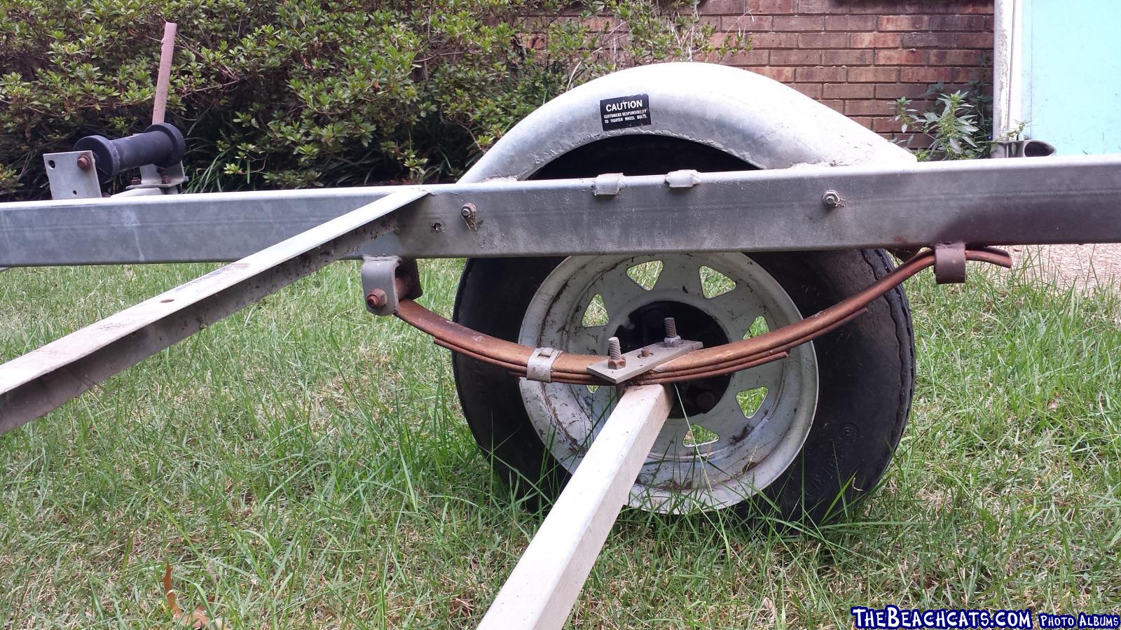

Agree that you can probably make adjustments, but will need more pics of your trailer. Looking the picture you posted, just move the bush. icon_biggrin
Actually, is that a bow stopper about halfway down the trailer? You may have a converted jet ski trailer.
Add some pictures to your album of the trailer cross bars and axle and how they are attached to the trailer.
DamonLinkousActually, is that a bow stopper about halfway down the trailer? You may have a converted jet ski trailer.
That IS indeed a bow stopper, and judging by the size it is indeed a jet ski trailer. There should be no problem with weight rating and what not, but I will have to assemble a better (longer) frame for it. four bars of galvanized 2" box tubing (two across to provide the proper width and two along the hulls) should do just dandy. I can manage the width based on the current configuration that fits the rollers precisely under the hulls, but would appreciate suggestions for the necessary length to properly support a P16.
Here is a better view:
http://www.thebeachcats.com/gallery2/main.php?g2_view=core.DownloadItem&g2_itemId=105844&g2_serialNumber=3
Mike
Prindle 16
Rochester, NY
What are the existing cross supports made of? They appear to be like wood 2x6's ?
I would keep my eye out over the winter for a genuine beachcat trailer and sell that one on craigslist I think.
Ugh, looks like I really pood the screwch with the trailer... I just walked up to it and lifted one of the hulls with my hand (the cat is tied to the trailer), and the trailer is WAAAY too wobbly to put on the road - the wheels are too close together (4 ft maybe) to support a cat. I was planning to pull off the 2x6 lumber and replace it with a wider and longer box steel frame, but I think it is too much trouble to move the wheels farther out. I will probably have easier time adapting a wider boat trailer to my cat.
I doubt that I will be able to find a cat-specific trailer in my neck of the woods, at least for less than what I paid for the boat itself. There are far more cats without trailers than trailers without cats on craigslist. Especially over the winter - nobody trades boat trailers in the snow. But taking a wider trailer and adding the necessary beams to it should not be a big problem.

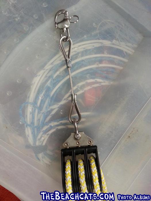

Hi. I am also interested in fast rigging, and I get my G-Cat ready in 25 min or less on most days. Trailer the boat stern first, that way you can step the mast with a belay man off he bow. The side stays and trap lines stay permanently attached. The forestay gets a quick pin. I looked up the shear strength of those pins and they exceed the tensile strength of the cable - it's not going anywhere. You can add a small cable tie for insurance. All the rudders, traveler, etc. are quick pins, and the jib and mainsheet attachment are Wichard clips. You'll spend some extra money, but you won't deal with 'ring dings' anymore.

mgoltsmanUgh, looks like I really pood the screwch with the trailer... I just walked up to it and lifted one of the hulls with my hand (the cat is tied to the trailer), and the trailer is WAAAY too wobbly to put on the road - the wheels are too close together (4 ft maybe) to support a cat. IEdited by mgoltsman on Sep 26, 2013 - 09:01 PM.
My custom made trailer's wheels are only about 4-5ft apart. It has two pieces of steel U-bolted across, with rollers bolted onto the ends that to support the boat(you can get these at any boating or outdoors store)
come to think of it just about any cat trailer I've seen has the wheels set at only about 5ft apart, give or take a little. Even the real deal "cat hauler" trailers I've seen are like this. If you put them much further out than that, the wheel wells hit the hulls.
it's not like you're hauling a motor yacht, its a 290lb boat. Thats less that half of what a jet ski weighs. I can lift my whole trailer up, with the boat on it from the rear and have done it to pivot it when backing into a tight spot. The reason it is so easy to lift the hull on your trailer is because a majority of the boat is sitting in front of the axle.
Un-strap the boat, slide it back about 3ft, so that the front strap is just in front of the crossbar, get the thing insured for 100 bucks and go sailing! Save the trailer fabrication and messing around with a hair dryer to find leaks for the winter. I know plenty of people who sail with pretty bad leaks. just keep your trips short and drain the hulls in between outings. You need to determine what is actually a problem before you try to fix everything.
both your boat and trailer look like they are in great condition from the photo's. Take a picture of the rear so we can see where the wheels sit in relation to the boat hulls.

vinnyvincentMy custom made trailer's wheels are only about 4-5ft apart. It has two pieces of steel U-bolted across, with rollers bolted onto the ends that to support the boat(you can get these at any boating or outdoors store)
Well, the hulls are over a foot wide of the wheels on each side. Given that they are about 7' apart, the wheelbase is probalby something like 48", which should be suitable... I suppose you are right Vince. How far apart are your hull supports fore-to-aft? (behold the awesomeness of my maritime vocabulary!) I have maybe 4' between mine, and it feels a bit short. However, to fix this I would have to mount two rails lengthwise because the trailer frame is not much bigger than 4'x4'. The diagram here http://www.thebeachcats.c…-sail-tube-construction/ suggests 7', which feels more in line with 16' hulls.
Mike
Prindle 16
Rochester, NY
Your's are too close together, but it seems like it would work the way they are temporarily if you wanted to take the boat out on the water to test it out. Just strap it down good and keep it under 55. Once you shift the boat back a little, so the weight is centered over the axle, I really don't think it will be much of an issue.
Hook the trailer up once you shift the boat back and do some test runs close to the house and see how you feel about it. With the insurance really the worst that could happen is everything gets destroyed and they cut a check for more than what you paid for it.
You just want to make sure nothing crazy is going to happen like the trailer coming unhooked from the truck, or the boat flying off the trailer and cartwheeling down the freeway, because you run the risk of hurting someone else if that happens. Honestly if you keep your speed down none of this should ever happen regardless. The guy I purchased my boat from was using twine to strap it down!
Best case scenario and most likely is you're going to get out there this season, get some time on the boat and have a blast, then be able to determine what really needs to be done to everything to make it all more ideal.
To answer your question, I've never measured mine, but 7' seems about right. when I put the boat onto my trailer, the rear cross bars line up with the rear support and the front crossbar ends up just behind the front support. Basically just measure your cross bars front to back and add on about ten inches and you'll be in the ballpark. Just because this is the "right" spacing doesn't mean what you currently have won't work for you short term.

I had a Hobie 16 trailer in the back yard so I added some pictures of it. The basic design is a lot like Jacks build.
http://www.thebeachcats.c…ctures/?g2_itemId=105887
measurements are
Overal length 20 feet
Main rails are 48 inches apart
cross arms that support the boat are 8 feet long and 7 feet apart.
http://www.thebeachcats.com/gallery2/main.php?g2_view=core.DownloadItem&g2_itemId=105893&g2_serialNumber=3 http://www.thebeachcats.com/gallery2/main.php?g2_view=core.DownloadItem&g2_itemId=105901&g2_serialNumber=3

mgoltsmanThanks Damon, very helpful photos! I think I will be OK if I can find an axle tube about 5' long.
You don't want the tires or fenders under the hulls. If you have a blowout, the tire can do damage to both the fender and the hull. If you have a blowout on one side, replace both. Don't ask me how I know.
Measured the trailer width - 40" between frame rails side to side and 48" between the center lines of the wheels. Probably 8-12" too narrow, but marginally acceptable I think - especially after I drop the boat down by 4" after I replace the 2x6 lumber supports with 1x2 steel. Just have to be mindful on turns...

A note of caution, in Damon's pics above, on the left hand pic showing the entire trailer, the cross-beams are under-slung, this usually causes the cat to sit so low on the trailer that the rudders will hit the ground,especially if you have 8" wheels, mount the cross beams on top of the frame. Also, look closely at the brackets holding the rollers, notice those sharp corners? Just waiting to eat your hulls if you make a mistake loading and un-loading, they need to be rounded off, don't ask me how I know..... icon_biggrin
Edited by the-renovator on Sep 28, 2013 - 07:14 AM.
the-renovatorA note of caution, in Damon's pics above, on the left hand pic showing the entire trailer, the cross-beams are under-slung, this usually causes the cat to sit so low on the trailer that the rudders will hit the ground,especially if you have 8" wheels, mount the cross beams on top of the frame.
Since mgoltsman (is that your real name?) hasn't seen a lot of catamaran trailers I should have mentioned that this one was a little unusual because of the under-slung crossbars and the fact that it is welded together. I was using it to illustrate the overall geometry. Most of the galvanized trailers I see have the crossbars attached with U-Bolts. Having the crossarms on top also provides a level support for trailer boxes or tubes. This one needed the stack of 2x4's at the front to get front support for a box.
The hull support rollers are definitely homemade from off the shelve pieces, I agree with the-renovator but think it's more of a hazard to your shins when working around the trailer (don't ask me how I know icon_lol )

Rigging Prindle 16 : we always use "speedy connectors" any kind of snap shackle eg to attach blocks to boom to traveler, to lines to raise and lower sail jib,same for main sheet , Also use for blocks for jib and to attach to tramp carry xtra line in tramp pocket and use clips for xtra life vest(attach a whistle) and tool kit (always carry spare parts a few shackle etc)and righting bucket use of speedy connectors saves 5 to ten minute in rigging time
kernunnos correct about side stays, they usually stetch as season progresses so tape them with electric tape 4 or 5 winds around the shackle or pins so they never can come loose, move them down when wires stretch and retape, enjoy your Prindle Even with less sail area u should take any hobie 16, I have both cats and believe Prindle is the superior craft
My "quick release" block to boom. http://www.thebeachcats.com/gallery2/main.php?g2_view=core.DownloadItem&g2_itemId=108076&g2_serialNumber=4
Edited by peterk123 on May 08, 2014 - 05:09 AM.
