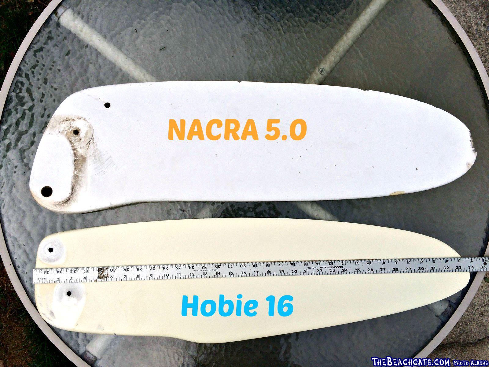

Thanks for the replies. Going to go the Wolfman route :)
Mmmmmmmmmm. It might work quite well. There's only one way to know.
http://www.thebeachcats.com/gallery2/main.php?g2_view=core.DownloadItem&g2_itemId=119423&g2_serialNumber=3
