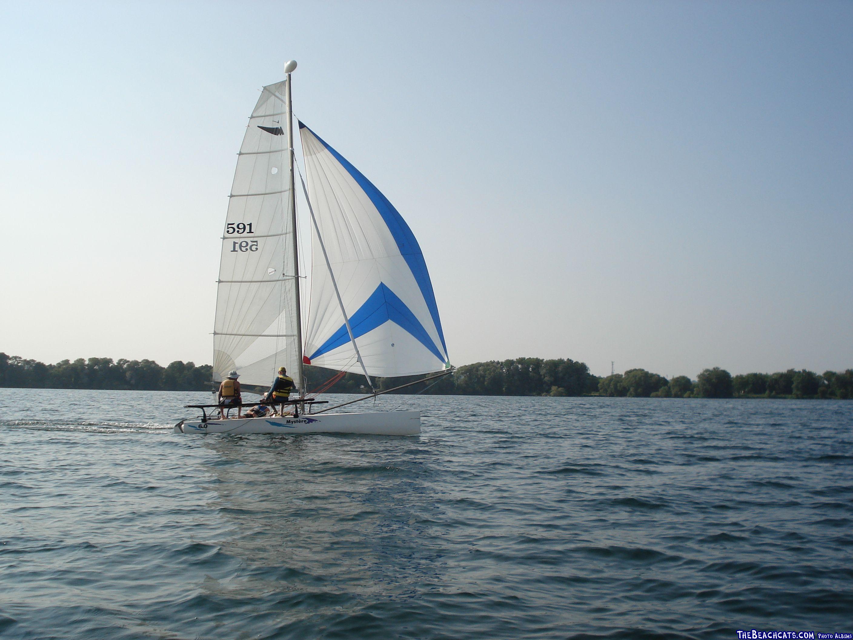

I've launched the kite from my 20'x10' beast 8 days now, 6 of them solo...lots to do when solo, so I've mostly furled the jib when the kite is up. This day was pretty light wind, & a big crowd on board, but one guys wife chased up in a Seadoo & took photos.
http://www.thebeachcats.com/gallery2/main.php?g2_view=core.DownloadItem&g2_itemId=109476&g2_serialNumber=4
Couple of questions regarding setup & trim.
In this photo you can see the foot of the kite is horizontal, due to the angle of the spin pole. I know from monohulls they "open or tighten" the spin by allowing the pole to rise, or winch it down.
Is there a rule of thumb, or a "standard" angle for the pole, considering you cannot control it on the fly as is the case on the monohulls?
Also, you can see that the telltales on the main are flying, but I have often seen them not in trim. How far can you safely travel out to trim the main without jeopardizing the mast?

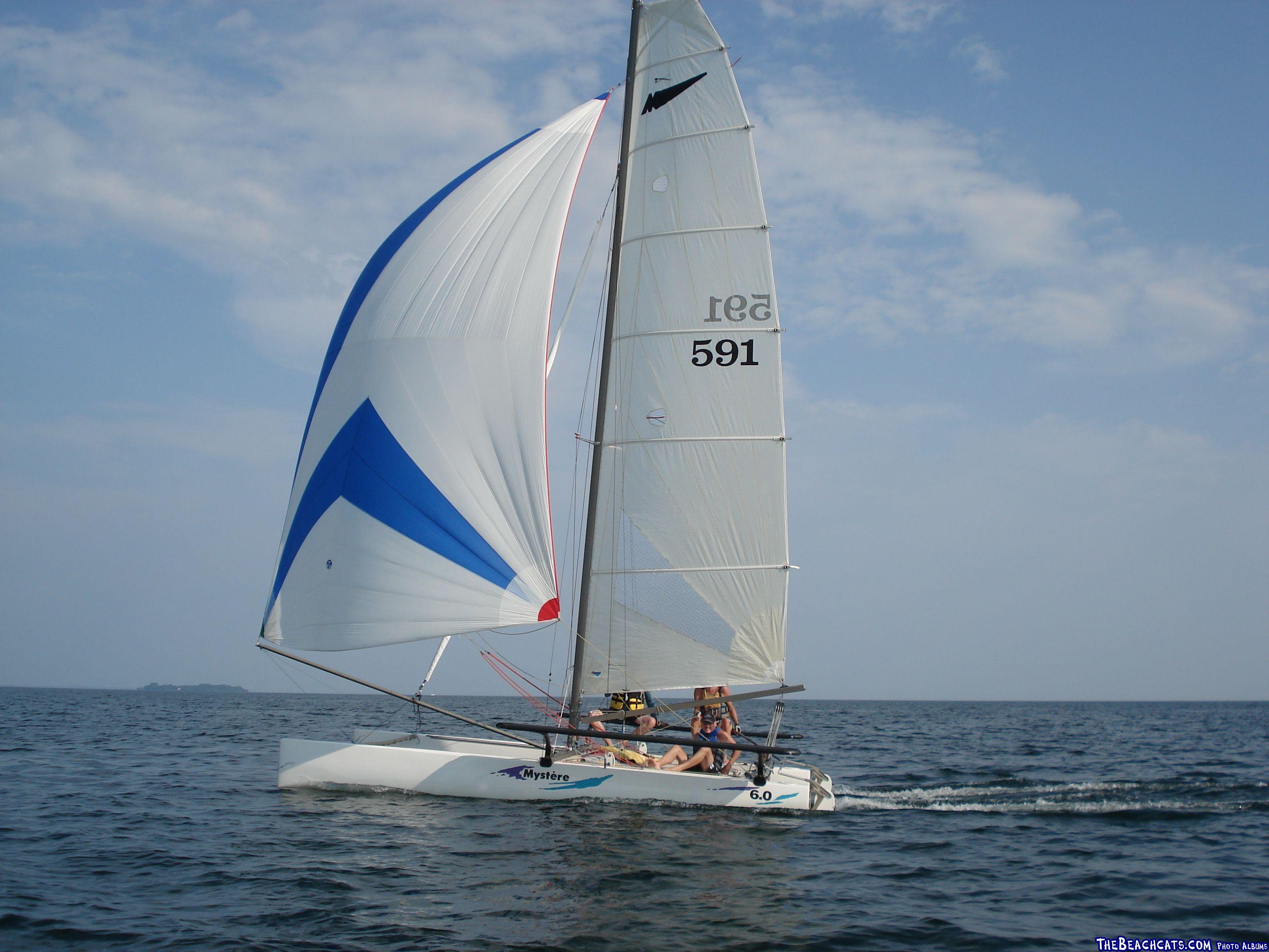

http://www.thebeachcats.com/gallery2/main.php?g2_view=core.DownloadItem&g2_itemId=109477&g2_serialNumber=3
In the image above you can clearly see the sheet angles, going to the ratchet block on the rear beam. Most people seem to locate the blocks on the stay adjuster. As you can see, that would change the angle considerably, & pull the clew down more than stretching it rearwards. Which is better, or does it depend on the cut of the spin?
Lastly, how tight should the lines be from the end of the pole to the bridal tangs? I have seen photos showing the pole bent downwards. My pole is 2" aluminum, & takes quite a bit to bend it downwards. Should these lines be tight as in tighter is better, or just snug, or does it matter?
We used to play the end of the pole on the monos, throug a fair bit of arc, depending on the apparent wind, but you can't do this on the Cat.
Quote"open or tighten" the spin by allowing the pole to rise, or winch it down.
that can be controlled with the spin halyard - but i can't think of a time when i adjust that. I like my spin luff set the same in just about all conditions (it's all off the wind....)
QuoteIs there a rule of thumb, or a "standard" angle for the pole, considering you cannot control it on the fly as is the case on the monohulls?
the pole angle doesn't matter. what matters is
a. that your pole isn't so low that the snuffer/sock doesn't scoop water when running down a wave
b. your pole angle will directly effect luff tension. so that is a HUGE factor. On all sails you need luff tension. most modern spins a good starting point / rule of thumb is you should be able to grab your luff and turn your hand 90-180 degrees. this was an old method but still a decent starting point. once you start to set it the same all the time, you can make small adjustments and see what works best for you.
QuoteAlso, you can see that the telltales on the main are flying, but I have often seen them not in trim. How far can you safely travel out to trim the main without jeopardizing the mast?
i dont care much about my main tells with my spin up. but you can travel out a good amount (1/3 - 1/2 way) without any issue in light and med air as long as your still sheeted fairly tight (leech is still acting as a backstay). In very light air i will loosen my main a little and travel out a bit, but in most situations having it centered is good (and easy since i dont have to touch the main/travler sheets at all)
Quote As you can see, that would change the angle considerably, & pull the clew down more than stretching it rearwards. Which is better, or does it depend on the cut of the spin?
depends on the sail. the old mystere symmetrical sails were huge and had to be run to the rear beam. all the mysteres around here run tornado asymmetrical spins that are not as huge and can be run to the sidestays
QuoteShould these lines be tight as in tighter is better, or just snug, or does it matter?
TIGHT! you want to bend your pole down a fair amount (and you should have a loop under your furler to help pull the middle of the pole up) - the bend is needed to avoid your pole from inverting (bending upwards) during use. this would / could cause several issues: it could invert, revert, invert, revert during use and thats not good. plus it would be lengthening / shortening / lengthening ... the pole which could cause crazy wear on your spin attachment points, not to mention you could possibly break off a bow tip (where the bridal runs through) with all that craziness..
I'm no grue. but in the second pic, you can see the loop of line under the furler. Tightening the lines would bring the pole down and tighten the luff.

You want at least a little pre-bend in that pole. Probably more than you have there. The amount of bend is not all that critical, we would adjust it to achieve better luff tension. Hoist you kite all the way up, I would want it to be able to tighten past the 90* twist that was mentioned. If it's too loose, add a little more prebend. Then you can make a mark on your halyard that will be close to the clearing point at "proper" tension. You can adjust it in and out from there, but it will give you an idea of what's going on.
Keep driving the main, I used to sheet it tight and forget about it. I found serious speed when I started trimming it. Don't travel out unless you need to de-power. Let out enough sheet to get the tells flying. I probably pull in 4-6 feet of sheet every time in return to an upwind sailing trim just to give you and idea. IMO, these masts are a little tougher than some make them out to be. Also let the mast rotate all the way out, if you have a positive rotator, use it to point the rotator bar straight down the beam.

Like Andrew said, don't focus too much energy on the main. Sail the angles hot downwind. Focus on the luff, sail just on the edge of the luff curling. Tiller and the spin trim are a teamwork thing. Hit that apparent wind, then it's magic, just keep it in the grove.

The boat is a 2000, delivered to original ownerwin 2001, I don't think the kite is original. It looks brand new,(North Sails) & is non symmetrical.I measured it roughly as 28'x24'x17' not sure how that compares to a T spin. I think I'll try moving the blocks. I used a turning block on the front beam,(just because they were already there for barberhauler I think) to get better angles on the ratchet. Moving them would mean 15' less sheet.
QuoteI'm no grue. but in the second pic, you can see the loop of line under the furler. Tightening the lines would bring the pole down and tighten the luff.
I tightened them up quite a bit. The PO had hi tech lines with SS hooks to slip into the fitting on the front spreader bar, but they seemded about 6" to short, maybe they used a different spin pole. I used some Sta-Set that I saw in one of the original photos, but it seems to stretch somewhat. Under power the pole lifts enough that the loop under the furler shows some slack.

QuoteI tightened them up quite a bit. The PO had hi tech lines with SS hooks to slip into the fitting on the front spreader bar, but they seemded about 6" to short, maybe they used a different spin pole.
I just noticed that your spin bridals don't go to your bow tips. this is the first time i have ever seen a boat like that. Please verify this is correct - looks like your pole is prime for inverting with that rigging.
PS - 6" short may be perfect when the pole is bent down -
QuoteI used some Sta-Set that I saw in one of the original photos, but it seems to stretch somewhat. Under power the pole lifts enough that the loop under the furler shows some slack.

QuoteI just noticed that your spin bridals don't go to your bow tips. this is the first time i have ever seen a boat like that. Please verify this is correct
Correct. They go from pole end to a fitting on the front spreader bar, which is basically where the regular bridals attach to the hull.
On the 10' beam boats, the front spreader bar,(a 2" pole that also serves as front bar for the front tramp) is required. It has a fitting at each end for the spi bridals, that is the standard factory setup. I have seen where people have drilled holes at the bow, & some modern boats have them, but I have not seen that on the Mystere 6X's
The bows make more sense, the angle is more favourable than going back to the bridals.
