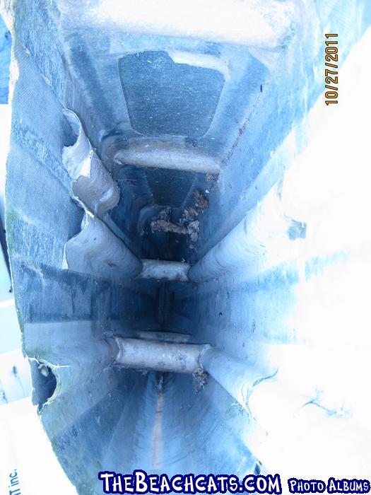

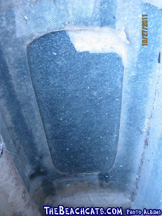

Andre, is it not better/cheaper/lighter/stronger to borrow aircraft technology & utilize a couple of ribs/stringers to give support vs thick enough glass?
When I was looking for a T, the decks seemed to be 1/4" ply, supported by a stringer every 16" or so. It would be VERY easy to make them using thin cardboard,(that's what Nacra used) wetted then overlayed with cloth.
Wet cardboard, fold into a "T" shape, with the vertical leg of the "T" a fold upon itself. You have then essentially built a structural beam, with a wide flange for the deck to rest on. If you now visualize the beam lengthways, you leave 4" extra of cardboard at each end. The extra can be folded 90* & serve to tab the beam to the inside of the hull. This can be done with the vertical leg of the "T", and the "arms".
Here are a couple of photos of an N5.2 hull. They used cardboard tubes to give rigidity. The actual decks are pretty thin.
http://www.thebeachcats.com/gallery2/main.php?g2_view=core.DownloadItem&g2_itemId=82860&g2_serialNumber=4.
http://www.thebeachcats.com/gallery2/main.php?g2_view=core.DownloadItem&g2_itemId=82854&g2_serialNumber=4

Edchris177Andre, is it not better/cheaper/lighter/stronger to borrow aircraft technology & utilize a couple of ribs/stringers to give support vs thick enough glass?
Thank You Edchris,
This is interesting stuff and the cardboard tube trick, I will certainly
remember and try.

Andre,
Great job documenting the repair. Did you have any stringers under the rotten foredeck when you remove it?
How thick was the deck that you removed? Like Edchris mentioned, mine has stringers about 16 inches apart and a 1/4 inch plywood deck. My plywood stringers have started to delaminate and I am thinking about drilling into them from the top,injecting epoxy, and then using stainless screws to pull them back together.
Any other ideas would be appreciated. Do not want to remove the decks if at all possible.
Pete
Pete,
No stringers whatsoever, just a thin under-deck, balsa ( grain vertical )
and a epoxied deck with gelcoat. About 2 centimeters thick.
In the bottom of the hulls a tempex foam block.
Around the rear portholes theres som minor delam. Gonna take care
of that next season.
Removing front or rear-deck is do-able, depending on your space for
working on the cat.
The injection-method is something for next season, never have done that.
Season is closing overhere, just wanna sail this T before that.
