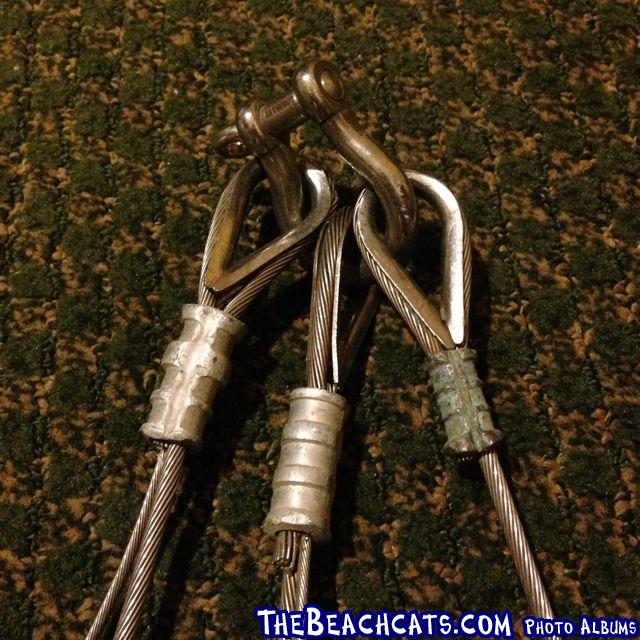

I'd like to add a second pair of trapeze wires to my 5.5 uni. Reason being I'll usually be sailing with someone else on the boat (it will give them something to do). And since I'm running a bigger sail (from an 18 square) it will be nice to have the option for two people trapezing in bigger winds. I also hope to add a jib some time, so I'll will need crew wires then for sure.
I've heard most folks use 1/19 strand (2.4mm or 3/32"). I don't want vinyl covered wire. I don't like the idea for trapped moisture/corrosion reasons, but honestly, my current trap wires aren't covered (neither are any of the stays) and I'd just like them to match. Can anybody recommend a good mail order supplier that can make me some up?
My other questions are: Should I get the second set of crew wires made exactly the same length as the skipper wires, or shorter? It seems that because they are further forward, closer to the mast, they should be slightly shorter. But maybe this is taken up in the adjustable line part. Crew trapeze placement is up near the front beam on these boats, correct? I think I read somewhere the crew's trap shock cord actually runs through the front beam. I'm also not sure if my uni-rig skipper wires are placed in the same spot as the sloop models, which might affect things. They come down to the hulls just a few inches aft of the side stays, with shock cord through grommets in the tramp. My final question is, how do I fit two extra thimbles on the shackle at the mast hound? It's already pretty full with three other thimbles (forestay and shrouds). My current trapeze wires are swaged with the shrouds. (BTW, I realize that in this pic the forestay thimble isn't in the middle of the shackle like it should be…).

It looks like two extra thimbles will probably fit your shackle..but if not...get a slightly larger shackle. May have to take up the extra 1/8"-1/4" in your stay adjustments.

On a 5.5 SL the wires are the same length and the crew (front) goes through the main beam. If I were you, I would measure what you have and get them custom made.
You don't have a stock 5.5 sl or uni. You have an 18sq mast that is longer than a SL or uni and the hound may be in a different spot and the beam has been cut down to 8 or 8.5.
Do you have an extra hole on the mast hound above the hole your using for the shrouds and fore-stay? If so, use it for the trap wires.
If not use a bigger shackle and / or get the wires on each side of the boat made with one thimble. (two trap wires one thimble)

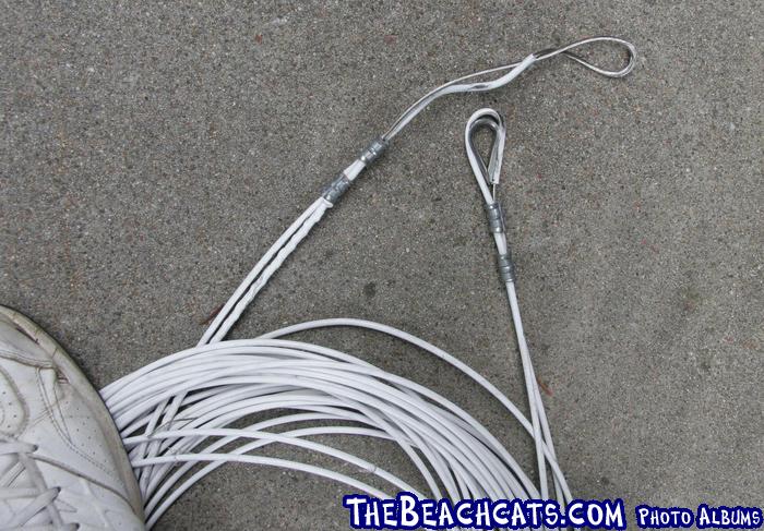

i know you don't want vinyl coated trap wires but i wanted to share what can happen with vinyl coated trap wires if the coating is not removed under the swage press and over the thimble. i had these fail because the swages slid down the wire and the thimble came loose.
http://www.thebeachcats.com/gallery2/main.php?g2_view=core.DownloadItem&g2_itemId=118898&g2_serialNumber=4
this also shows how you can have two trap wires using only 1 thimble, which works great for keeping your shackle simple and free to move. one continuous wire.

I do not have an extra hole in the mast hound. There's nothing wrong with my existing trap wires, and they are swaged with the side stays, so that already saves a couple thimbles on the shackle. I figure there's no getting away from 5 thimbles on the hound, even with continuous trap lines (the pair sharing a thimble each side).

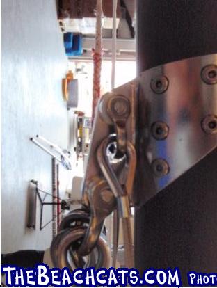

sierracat,
even if you don't have the big hole in the middle, don't you have 2 holes in the mast hound?
http://www.thebeachcats.com/gallery2/main.php?g2_view=core.DownloadItem&g2_itemId=118909&g2_serialNumber=3

Here is another way to attach trap wires to mast hound all using one shackle.
https://s3.amazonaws.com/dunedincauseway/masthound.jpg

Nope, I have a single hole in my hound, currently with one shackle holding three thimbles.

Other options:
- If the shackle pin isn't long enough for the setup above, put the jib thimble there. I did that on my previous boat.
- Two additional shackles, one each side, with shroud and traps
- If you can make clean and elegant knots, using line for the traps is an option too.
If you will change or add shackles check thimble diameters
