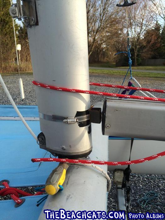

I used my boom as gin pole. With the addition of this small appliance and some guide liines, Hobie ez up as guide. Make sure mast is empty.
http://www.thebeachcats.com/gallery2/main.php?g2_view=core.DownloadItem&g2_itemId=113225&g2_serialNumber=4
