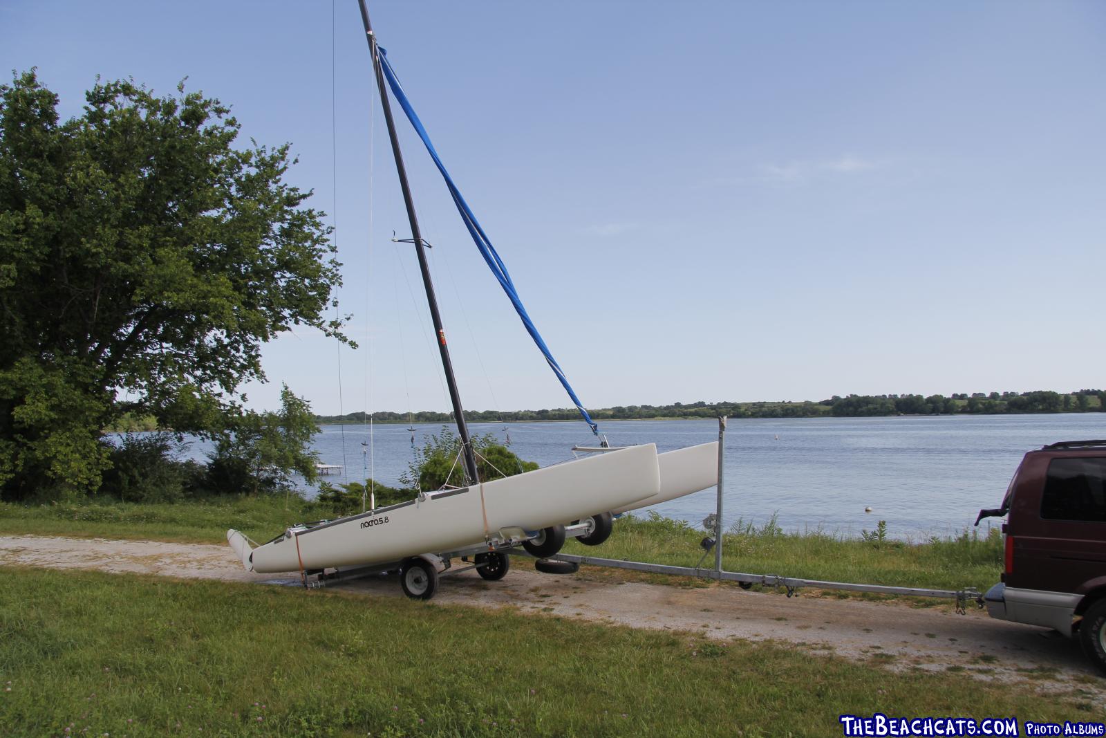

https://www.thebeachcats.com/gallery2/main.php?g2_view=core.DownloadItem&g2_itemId=119536&g2_serialNumber=3
https://www.thebeachcats.com/gallery2/main.php?g2_view=core.DownloadItem&g2_itemId=119535&g2_serialNumber=3&g2_GALLERYSID=d802737e545768ca0d65412b1b0d601c
