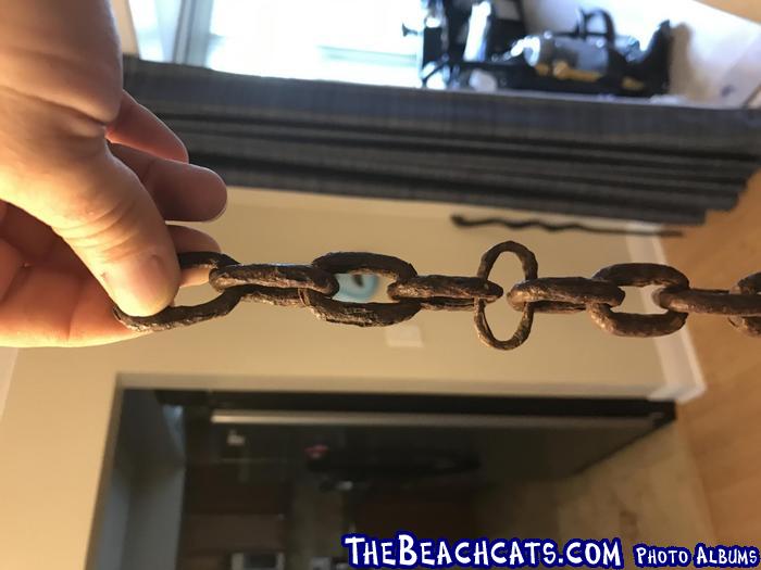

Speaking of chain - It's been a while since i inspected mine. was thinking about that on sunday ...on the beach, in my friends work truck as the storm was passing overhead. My boat on anchor about 50' in front of me. Boat got washed and a blow dry (prob lower 20's) - no drama but the wind shifted from a south westerly to an easterly ... and blew my boat off shore (still on anchor but now about 70' from me with the tide almost 1' above the predicted 3' level.
Anyway when i get out there and go to pull my anchor ... it comes up like it was never set (due to the boat shifting 180* and bouncing around a bit)... a little scary
then i looked at my chain - very scary
https://www.thebeachcats.com/gallery2/main.php?g2_view=core.DownloadItem&g2_itemId=128177&g2_serialNumber=4
