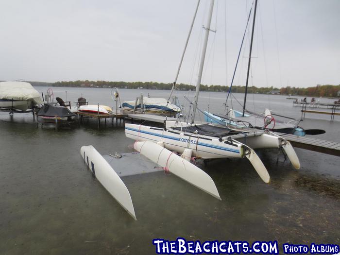

What's wrong with this picture?
https://www.thebeachcats.com/gallery2/main.php?g2_view=core.DownloadItem&g2_itemId=129165&g2_serialNumber=4
That is one unhappy, upside-down, dis-masted Dart 15!
At least it is surrounded by good company in good shape, so it has to know that things will be right soon enough.
And where is that Ackermann inspired rudder system?
QuoteWhat's wrong with this picture?
Dirty rudders on the Nacra?
so ...
what's the plan now?

What's wrong ? Too many boats ! Pete

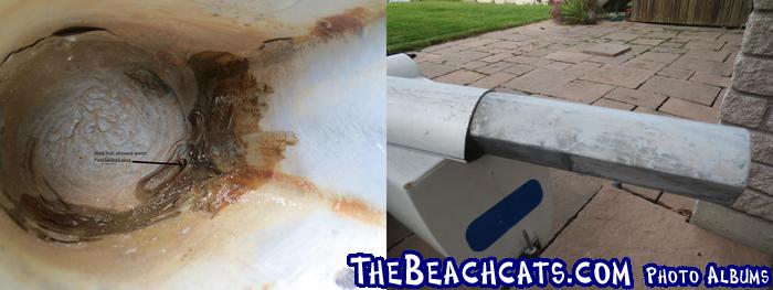

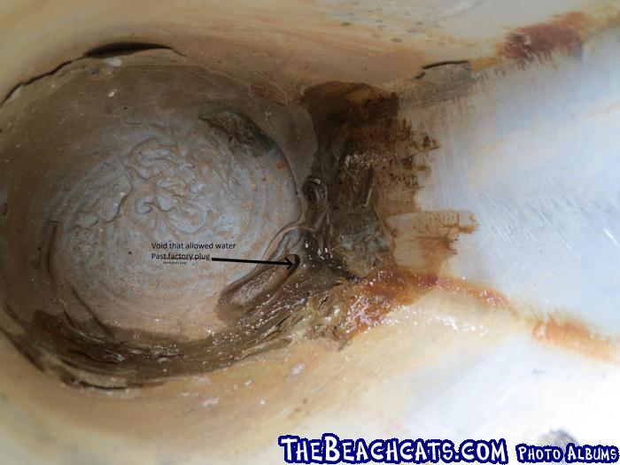

After retrieval & inspection it turns out the lunchbucket who originally built the boat, in Jolly Olde England didn't quite take enough care with the mast sealing.
Appx 4" up from the mast base is a plug of some sort, that is sealed via a liberal smear of some dark brown compound. Unfortunately, for me, they missed a small corner, resulting in a 1/8" gap. The sheave for the main halyard is between the mast base & this plug, & uses a hollow rivet. This allows water between the base & plug, & the substandard plug allowed the mast to fill.
Even towing with a powerboat we couldn't right it on the lake, so I unpinned the shrouds, hauled the mast up beside the boat, removed the sail, then put the mast across the turtled Cat & towed everything home.
The initial plan was to just leave it upside down in the bay overnight, but enough other boaters came buy to effect a rescue. I did notify the police to prevent expensive assets being mobilized if someone reported an upside down boat with no one around.
I couldn't flip the carcass by myself, nor could I get it up on the lawn. It sat upside down for a couple of days, got it flipped & hauled yesterday. It's kind of a b*tch to flip with only two people. We tied a line from bow & stern of the outside hull to one of the boat lift in order to prevent things from wanting to slide away while we lifted the inside hull. In hindsight we probably should have lifted it just few inches, then popped the hatch. That would have instantly drained the water & made the job easier.

On the lawn, along with the rest of the removed parts. It was a bit of a challenge to remove the shroud pins, as they were underwater, & under tension. I had to use pliers to yank the pins out. Amazingly, we never lost a single part. I fully expected ring dings, pins, pliers to be expendable, but we managed to hang onto everything. I probably should have tied a line to the rudders, as they are only held in place by a spring tab, but they stayed on for the tow home.

I have everything back on the lawn. Removed the mast base, (had to go buy a 3/16" cobalt bit), found the problem. As soon as things are fully dried out I can re-seal & reassemble. Just thinking about what product will stick to aluminum & what they used for a sealant. Plus my spare sail is very clean!

Got the mast inside today, getting it fully dried out. I'll have to get the inside cleaned up before sealing. I'm going to try a spray rubber product called Flex Seal. Supposed to be for sealing aluminum gutters etc. Plus it should be very easy to spray a few coats around the entire area.
https://www.thebeachcats.com/gallery2/main.php?g2_view=core.DownloadItem&g2_itemId=129177&g2_serialNumber=4

OK, flex Seal is out. I don't think any sort of resin is a fix. The mast base, after removal & clean up should be an easy fix by marine silicone around the base & flange.
The bigger problem is the middle of the mast. Most of these were supplied as the more expensive 2 piece mast, in order to car top the Cat, & many,(most) in the UK use this option. A tremendous number of D15 sailors travel a racing circuit, (they sail all year long), & the 2 pc mast avoids extra charges on ferries, + it allows them to haul a travel trailer by car-topping. Most of the sailing clubs have camping areas.
The join is a simple male plug on the top section, that fits into the female bottom section. There is an internal plug inside the mast, at the top of the bottom section. These masts were ahead of their time, tapered, & quite flexible. They can be bent with downhaul. This means the area at the joint also flexes & is hard to keep sealed. It is also 10' underwater if turtled, creating a fair amount of static head.
Anything stiff, like resin, would quickly crack, & it would be hard to obtain good adhesion to aluminum. That made my initial thought of Flex Seal.
The "stub" is 11 1/4" long, the receiving socket is 13", so I only have 1.75" "free".
I'm now thinking something like Grace ice/water shield, the membrane they use on roofing. I can place it over a dowel, push it down into the mast, then tamp the bottom in place, then using a piece of pipe, roll the edges against the mast wall. The stuff seals itself around nails pounded through roof membranes, adheres extremely well, yet is very flexible. I think it would be better than pouring a bunch of marine silicone, & smearing it around the perimeter. The Grace Water shield adheres strongly enough that it will pull the top layer of plywood off if you try to remove it from a roof.
