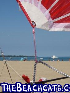

I've been using a Spinnaker 'Spintail' tied into the center of my spinnaker sheet for several years. This allows the spinnaker to change tacks without a big clumsy knot sliding across my forestay and possibly getting hung up.

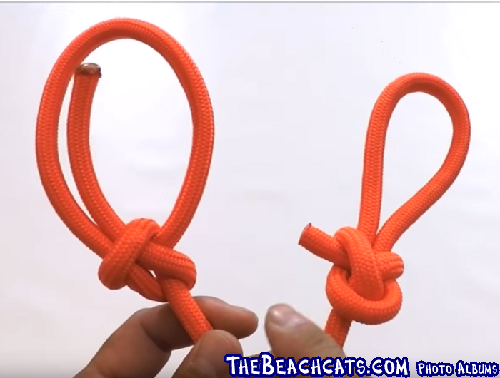

i'm wondering what knot people use to tie the tail to the SHEET? I don't have any problem tying to the clew of the spinnaker, i use an anchor knot which is the one on the right in this picture.
