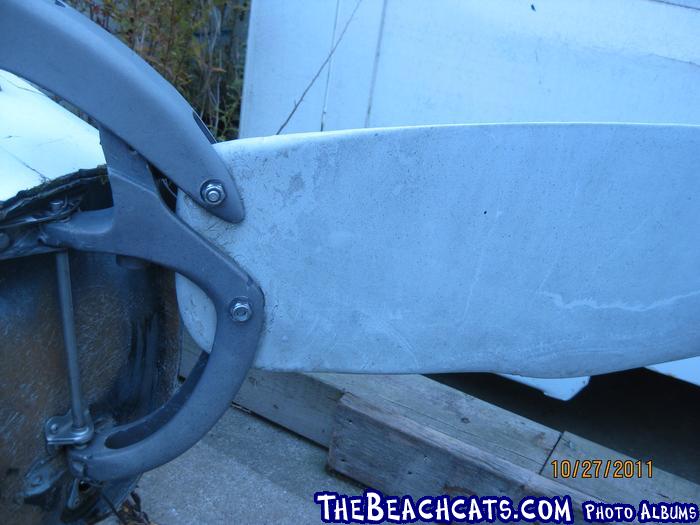

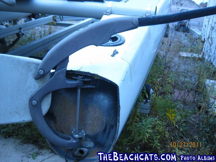

Last resort is to build a Hacra, and frankly I would love to try this myself, hang a set of Hobie 16 rudders on it. You might even be able to adapt the Hobie castings.

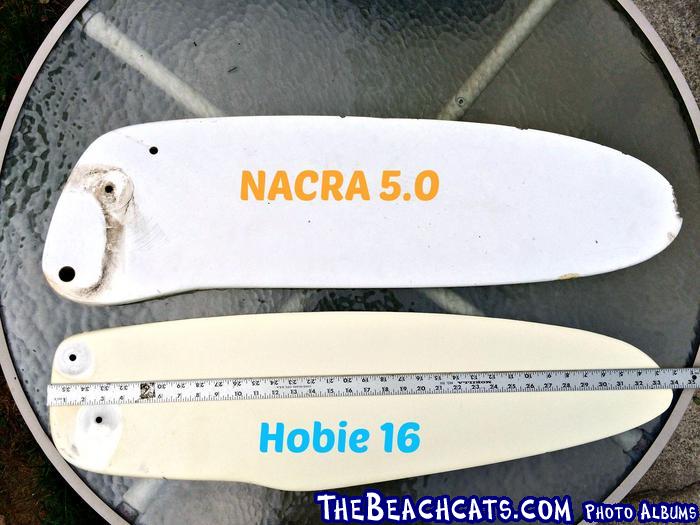

The castings are not to hard to find, the blades are the issue. You can easily find blades for the round bottom hulls, ie N5.2, but the skeg hulls are a much tougher find. If you look at the N5.0 or 5.7 hulls from the side, you see the last couple of feet have a definite rise at the bottom. This means that the rudder blades must be longer in order to keep a decent amount of blade in the water. Don’t be tempted to buy some of the shorter blades, thinking they’ll do, you won’t have rudder authority.
leeboweffectLast resort is to build a Hacra, and frankly I would love to try this myself, hang a set of Hobie 16 rudders on it. You might even be able to adapt the Hobie castings.
https://www.thebeachcats.com/gallery2/main.php?g2_view=core.DownloadItem&g2_itemId=119418&g2_serialNumber=4
This is actually a fairly easy project. It requires drilling one new set of holes for the Hobie gudgeons, & obviously filling the old, & making sure you mount the new gudgeons plumb. You can see that the top Nacra fitting was used, & new holes made for the bottom fitting. It looks like they lft the old fitting in place & just ground off the "ears".
The rudder pins will go straight in on a 5.0 or 5.7. Only the really old Nacras inset the transom, leaving a lip. Anything past about 1980 has flush transoms.
It had been done on a 5.2 we parted out, using H18 rudder assembly. I sent the entire 2nd gen rudder assembly to a fellow in Texas. It should work on a 5.0 if the blades were of equal length.
https://www.thebeachcats.com/gallery2/main.php?g2_view=core.DownloadItem&g2_itemId=82887&g2_serialNumber=6
https://www.thebeachcats.com/gallery2/main.php?g2_view=core.DownloadItem&g2_itemId=82884&g2_serialNumber=6
