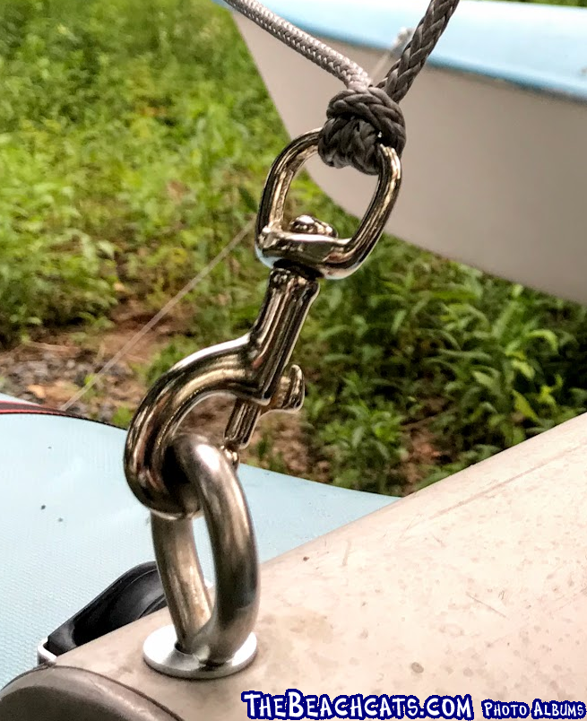

Given that the consequences of a failure in the dog clip are quite sever, I'd use something that actually had a load rating, such as the Maillon Rapide link, like you have attached to the front of the gin pole.

Given that the consequences of a failure in the dog clip are quite severe, I'd use something that actually had a load rating, such as the Maillon Rapide link, like you have attached to the front of the gin pole.

Uh, I have to echo Brett's sentiment; I broke a less than adequate rope over the weekend serving as my gin pole bridal; wasn't a big deal because I had 1 guy each on either shroud holding the mast in-line. Doing it solo would have been a problem. The gin pole bridals didn't suffer from near the tension change as the trapeze wires. In thinking about that and failures, I'm thinking of hooking the 2 trap wires up each side, independently, with one having the maximum amount of slack needed on each side to serve as a safety should anything give way on the tighter one. I've been using rated, locking carabiners for the hook-ups (???). A way to reliably and safely release just a little tension as the rig comes up would be nice, because as I think about it, mine relied on me not slipping. Would rather, when released the line locks up on the trapeze line tension.

All due respect to the poster. looks like a system that works fine but I have several concerns with the images posted above
how is the wooden pole held in place? looks like friction alone. seems like a liability
the line used as the bridal/anti-sway are the same line - if it breaks in 1 place it will effect other location
this same line is not secured to the beam / eye bot (port side) - it is looped around the "dog clip" this could very easily slip - again effecting more than 1 line / area of support
the anti-sway cables are connected to the front of the mast via an eyestrap (i assume there are no trap wires to do this):
1. if a line breaks i have concerns those small rivets are gonna hold the mast up - and if they rip out... that is a bad spot for bent up metal
2. that eye strap would eat up my jib leach
3. how do you get them off the mast after stepping? (looks like it's kinda high up the mast)

All good points!
- The wooden pole has a pin sticking out that fits snugly into a hole in the mast (not visible.)
- The line is one piece but the binding loop-throughs don't slip. This I tested by putting it under load with a winch. If one section broke (really unlikely with 1/4" Dyneema!) the other sections do not directly receive the lost load (the loads are 90 degrees off axis.)
- Trap wires come in from a much higher, more oblique angle so the leveraged loads are much greater (and the mast center is unsupported.)
- The rivets holding the eyestrap are Monel - same as the ones holding on the hound. The anti-sway lines are never nearly subject to the full loads that the forestay or other standing rigging supports. And, the sway is gradually taken up by the shrouds in the last 85% of the raising -- just when the mast could exert the greatest swaying force.
- It's a pretty curvy low-profile fitting that eyestrap; we'll see!
- I mounted the eyestrap just within my reach standing on the forward beam.
All the best!

Great answers! I didn't see trap wires in the images but i am happy to see your responses.
you seem to be a very "handy" sailor - so i hope i don't sound like i am preaching or being argumentative : with all the respect in the world ...
My only concern is that "loop" (port side / dog clip) : i am certain under a few circumstances .. that loop will pay line out
that loop is a simple luggage tag (used all the time with spliced end/eye splices). I have used this "binding" many times in many scenarios - I have tried to use this on my jib clew and spinnakers - it fails (slips) even with non dyneema.
this is not secure, esp using very slick non jacketed high modulus line (dyneema), just a smidge of slack in that tag and it will freely pay out... add some water to that somehow and it's even slicker
I always try to prepare for worst case scenario - ymmv:
if somehow the port bridal line fails it could pay out and now you have lost the mast lower guy line too.
https://www.thebeachcats.com/gallery2/main.php?g2_view=core.DownloadItem&g2_itemId=131491&g2_serialNumber=3
Edited by MN3 on May 28, 2019 - 06:33 PM.
Quote I've been using rated, locking carabiners for the hook-ups (???)
carabeeeners are great - as long as they aren't the one's that come free with a water bottle :)
i even trust those dog clips pictured above if they are marine grade - i have a brass one that has lasted me 19 years

Your concern has convinced me. I'm onto a reconfiguration! Thanks!
