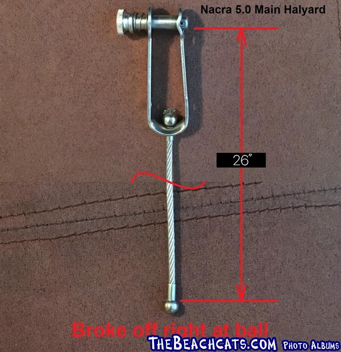

This is not possible on the Nacra 5.0. The halyard is a split wire/rope type. The thimbles of the wire portion must be on opposite sides of the mast head sheaves. To accomplish this the sheaves must be removed and the wire laid in. The thimbles will not run between the sheaves and mast head casting.

We broke the main halyard on the 5.7 last summer, it is the exact same setup as yours, & has to be replaced the same way. it let go where the little swaged ball holds the shackle.
We also tipped it in the water, then rested the mast end on the dock while we jury rigged a new shackle, as we didn’t have another wire.
QuoteGOTCHA - ugggggggg. I hate wire ropes.....
It’s not that bad. Because the wire runs over two sheaves, it only bends 90* at each side of the mast. The wire portion is short, & cannot be touched unless you are about 28’ tall. They last for decades, I had no meat hooks when it finally broke.
These legacy Nacra have a slug on the wire, which hooks under a fork, that is attached to the front of the mast, about 3’ down from the masthead.
You could change to all line, but would have to use no stretch line. The stock system you can use any cheap line, as the halyard hangs slack & the wire takes the entire downhaul load.

Te Nacra has a cast fitting that slides into the top of the mast extrusion. It holds the two sheaves, & seals the mast.
I can’t remember how far down it goes, I think just over an inch. The hook needs to be precisely positioned for reliable hookup. Murphy’s law says you’d end up drilling right on the edge of the casting, & unable to properly rivet the hook.
The other, (and bigger detriment in some cases), is raising & lowering the sail. With a hook, you need to be pointed right into the wind. For those who keep cats on lifts, or have to raise while tied to a dock, this can be a PITA.
My H18 & Dart really want to be pointed into the wind. The Dart is so fussy, I keep a bridle tied on the prevailing downwind side of the dock, & walk the cat from its lift, secure to bridle, then hoist. It is impossible to drop the sail unless direct into wind, especially in a blow.
The Nacra system may seem dated, but it is bulletproof for hoist/drop. The sail can be over against the shrouds, & it latches/unlatches first try, every try.

Quotehese legacy Nacra have a slug on the wire, which hooks under a fork, t
I didn't realize there was a fork system like the H16
My N5.7 has the fork and ball system on the halyard, I have done the Cat-tip on-shore in the grass. Makes things a lot easier than dropping the mast.

The main halyard is wire with a shackle and a ball stop. There is a hook at the top of the mast where the ball stop hooks into. Changing to Dyneema is possible, but not very efficient.

texastumaThe main halyard is wire with a shackle and a ball stop. There is a hook at the top of the mast where the ball stop hooks into. Changing to Dyneema is possible, but not very efficient.
+1 it looks like this.
https://www.thebeachcats.com/gallery2/main.php?g2_view=core.DownloadItem&g2_itemId=132428&g2_serialNumber=4
