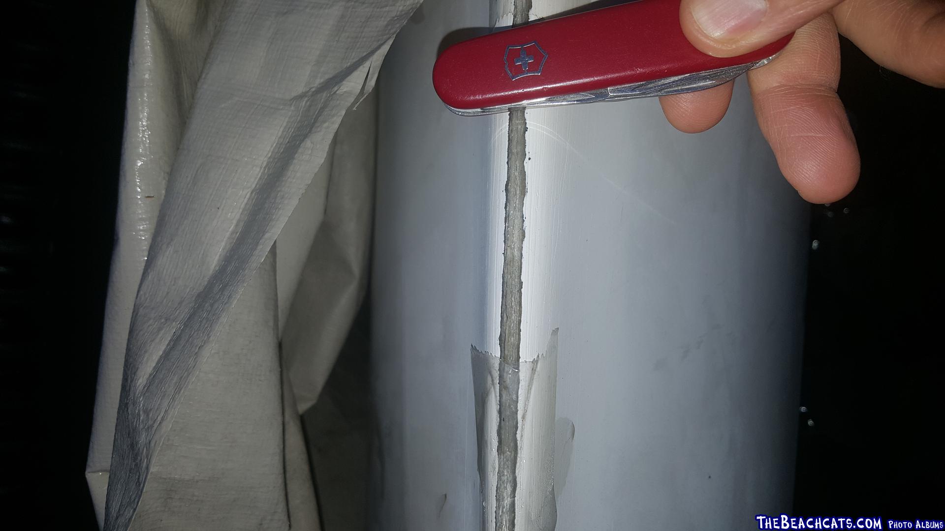

The skegs on the Nacra need some love. They are not terrible but the flat spot is about 1/4 inch wide at the deepest part of the skegs. I have read here about glass tape and epoxy repair. My question is, tape over a flat will make a flat face, does that matter or should i rebuild a sharp edge, an inverted vee? Thanks.

Can you get some images so others can give you more detailed suggestions?

I put an image in my folder titled nacra trailer.

Its worn through the gel coat, and appears small gaps are present.

Kenny i certainly defer to your experience but may i ask why use glass?
if he has no damage and is worn down to the glass but not any further, is more or new glass needed?
Did you see the damage?
it looks very minimal
https://www.thebeachcats.com/gallery2/main.php?g2_view=core.DownloadItem&g2_itemId=132828&g2_serialNumber=3
Edited by MN3 on Apr 20, 2020 - 01:56 PM.
I was thinking what was worn off is less than the size of a pencil.

all that matters in my world is how much epoxy has been sanded off or damaged
it doesnt look like anything more than some very minor surface scratches on the exposed epoxy and that is why i say no new epoxy is needed
again i strongly defer to Kenny's knowledge. but unless he said he saw the picture and still suggest the use of glass - i stand by my statement that I would not add more glass/epoxy

Just now seeing this. If cosmetic build up is required, you need a filler, then gelcoat. Gelcoat has no significant strength, at least compared to epoxy. I would sand the area and apply an epoxy filler. Allow the epoxy to cure to the point where sanding produces a fine powder. Wash away amine blush with water and an abrasive scotch brite pad. Dry the surface with paper towels, or rinse well and allow it to air dry. Apply gelcoat as needed.
