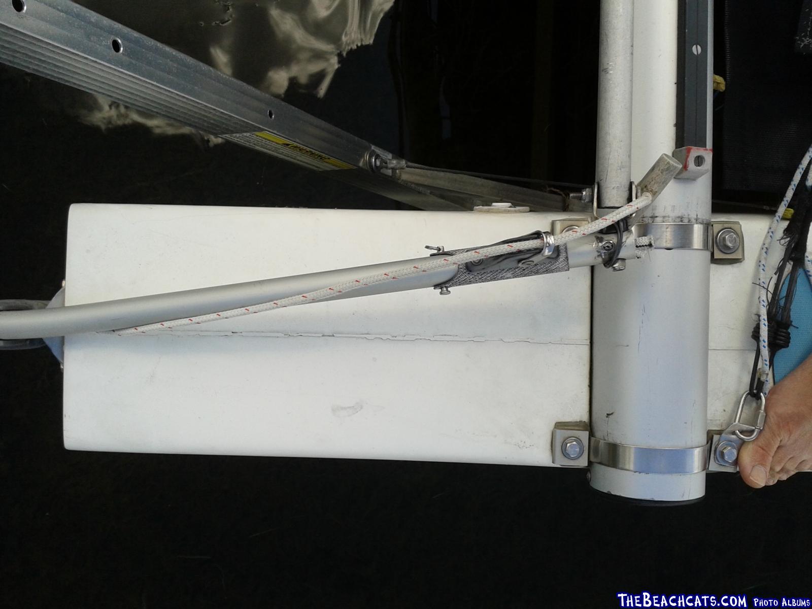

Get your cat lifted up, onto blocks, trailer etc. Then lightly pressurize that hull. take a bucket of soapy water & mop the hull, you'll see where the leak is.
I cobbled this up, for $1, to pressurize a leaky 5.0 hull. Turned out to be the actual drain plug fitting. MY 5.7 had a leak where the previous owner did a really crappy fix. A couple PSI & soapy water made finding the leak very easy.
The good news is even if it is leaking at the skeg due to a split, its a technically easy fix.

If it turns out you have hole near the skeg, (as I did in the 5.7 photo), don’t go to the effort of pulling off a deck.
Simply grind out the damage, fairing the glass removal away from the Center.
You can see how I did it in the photo.
Next lay up 3 layers of cloth, & using a needle pull a piece of string through in two places,(again as per photo. I used a bit of SS wire cause it was handy, but string would be better, easier to cut off flush).
Mix a wee bit of resin, add some thickener & wet the cloth. Let it just begin to kick off, then fold it into a taco shell shape.
Wipe some fresh resin around the perimeter, on the inside of the hole,(wipe down with acetone first to clean it up), insert your “taco”. Let it open flat, then use the string & a small weight to hold it in place. Thus goes easier if you flip the hull so gravity helps lay the patch flat. Let it set up at least a few hours.
Then add a couple layers of wetted cloth on the outside, laying a larger piece, the size of your grind out against the hull, then a couple progressively smaller pieces.
That will now be the strongest part of the hull.

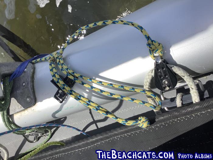

Quotethey both fought to keep the lines for the jib from hanging up on the mast),
Get about 5’ of 3/8” or 5/16” bungee & make a preventer. Tie one end to the end if the V brace bat, then lead the bungee through the bottom of the diamond wire attachment-around the front of the mast- through the other side diamond wire attachment-tie off at the opposite end of the an brace bar.
That will prevent the lines from snagging on the mast base. I don't have a good photo, but you can see the idea here.(click on the photo to enlarge it full size).
Look for what looks like an inverted V, with the apex at the mast.
https://www.thebeachcats.com/gallery2/main.php?g2_view=core.DownloadItem&g2_itemId=87705&g2_serialNumber=3
it is also in the NACRA manual, here,

Quote we didn't get far from shore and the steering was locking up intermittently, I told him oh boy we are screwed then it was fine for a while, long story short, if you have the crossbar in the wrong orientation the U brackets at each end lock the steering. That's going away this winter.
You've discovered how to lock up the steering. If you are on a tight budget, or just to get sailing this seson, just take a short piece of galvanized wired & wrap it around the portio you dont want to rotate
Its a bit Hillbilly, but takes 5 minutes & costs 50 cents. I got the idea from a poster here years ago. I've been meaning to change it to the expensive part each winter, honest...
https://www.thebeachcats.com/gallery2/main.php?g2_view=core.DownloadItem&g2_itemId=103610&g2_serialNumber=3

I think I get the routing of the jib sheet jam preventer and with the rudder cross bar I will get the right part over the winter but if I get a chance to go out again this season it will be the hillbilly fix until then.

QuoteCould I put a snap shackle in the middle of it to attach to the jib?-
Yes, you can do this. however, in very light wind, I mean the kind where you stayed out too long, & dont want to paddle home, any extra weight hanging on the clew is detrimental.
If your reasoning for the snap shackle is to leave the jib lines strung, & speed up attaching the jib, just make a soft shackle from a piece of thin line, something like Spyderline.
Unfortunately, this is the best photo I have. This setup I used on a 20' x 10' beast, I would use thinner line on a smaller Cat.
It's shaped like an X, two arms of the X tie to the jib blocks. the other two, one is simply a loop, the other ends in a monkey fist.
Simply slide the loop slightly through the clew, then put the monkey fist into the loop, & pull the loop snug. It won't let go, but is easily released with cold fingers.
https://www.thebeachcats.com/gallery2/main.php?g2_view=core.DownloadItem&g2_itemId=133338&g2_serialNumber=4
Monkey fist...A new knot to practice, love it!
QuoteThis setup I used on a 20' x 10' beast, I would use thinner line on a smaller Cat.
So line diameter is not important it's the strength that matters or should the dia. be the radius of the grommet for a snug fit?
