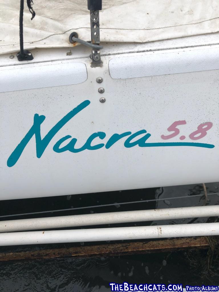

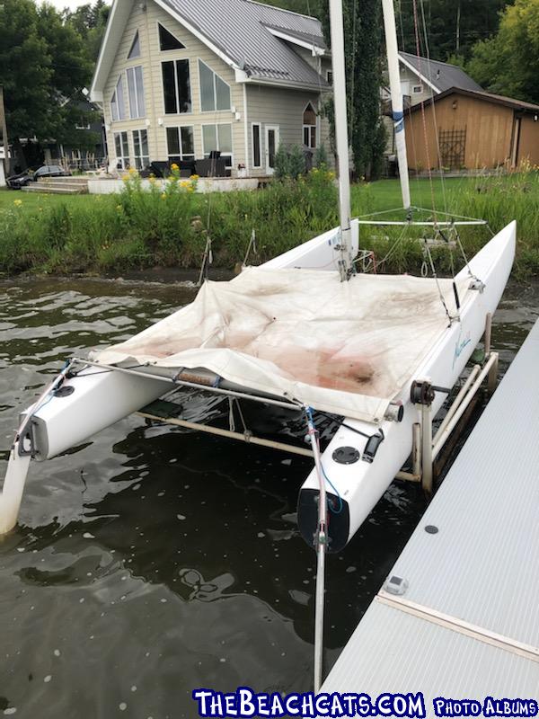

I'm concerned about the one chain plate to hull junction, the blisters, is that tramp rip repairable, the cracking on the corner of the deck in the one blister photo? I like that it has wing seats, but I might look at modifying the geometry..
Wish it wasn't sitting uncovered for the last few years. Said the hull plugs were pulled for storage and that there was water inside when he lifted the end. I like parts of what I see.. dolphin striker area looks good, and that bridle foil thing means it's an NA correct?
Thoughts?! Thanks in advance for any help!

Pass. Spend the $3000 grand you'll put into it on a nice boat.

All the legacy Nacras see those cracks near the chain plates. Where the tangs come out is a very tight fit, even a bit of flexing cracks the gelcote. My 5.7 is way worse, & we sail the hell out of it. The small cracks near the blister are also of little significance.
All used boats need some new lines, but it’s surprising what a pre soak in hot water/Oxyclean, then tossed in the wash will do.
That boat has the same decks, jib blocks & tracks as my N5.7. They leak water into the hulls, (Tofino is big rain area), because the rivets are hollow, & the decks direct rain onto the jib tracks. I put a tiny dab of silicone on each rivet, except for the 1st one,(to allow the hull to equalize pressure changes), then park the boat bow up.

I have both a 5.5 and a 5.8 none of them looks that ugly around the chain plates.
Without having seen the sails hoisted, the image indicates they are old originals that need to to be replaced.
Don´t buy that wreck. It will cost a lot to make it sailable.

Don't trust any boat that has been sitting around for several years with water in the hulls.

IMHO, the chain plate cracks are minor- I’ll post a photo of our 5.7. If these are ugly, mine look like a disaster, yet we double trap two grown men in winds that move us at 23mph.
