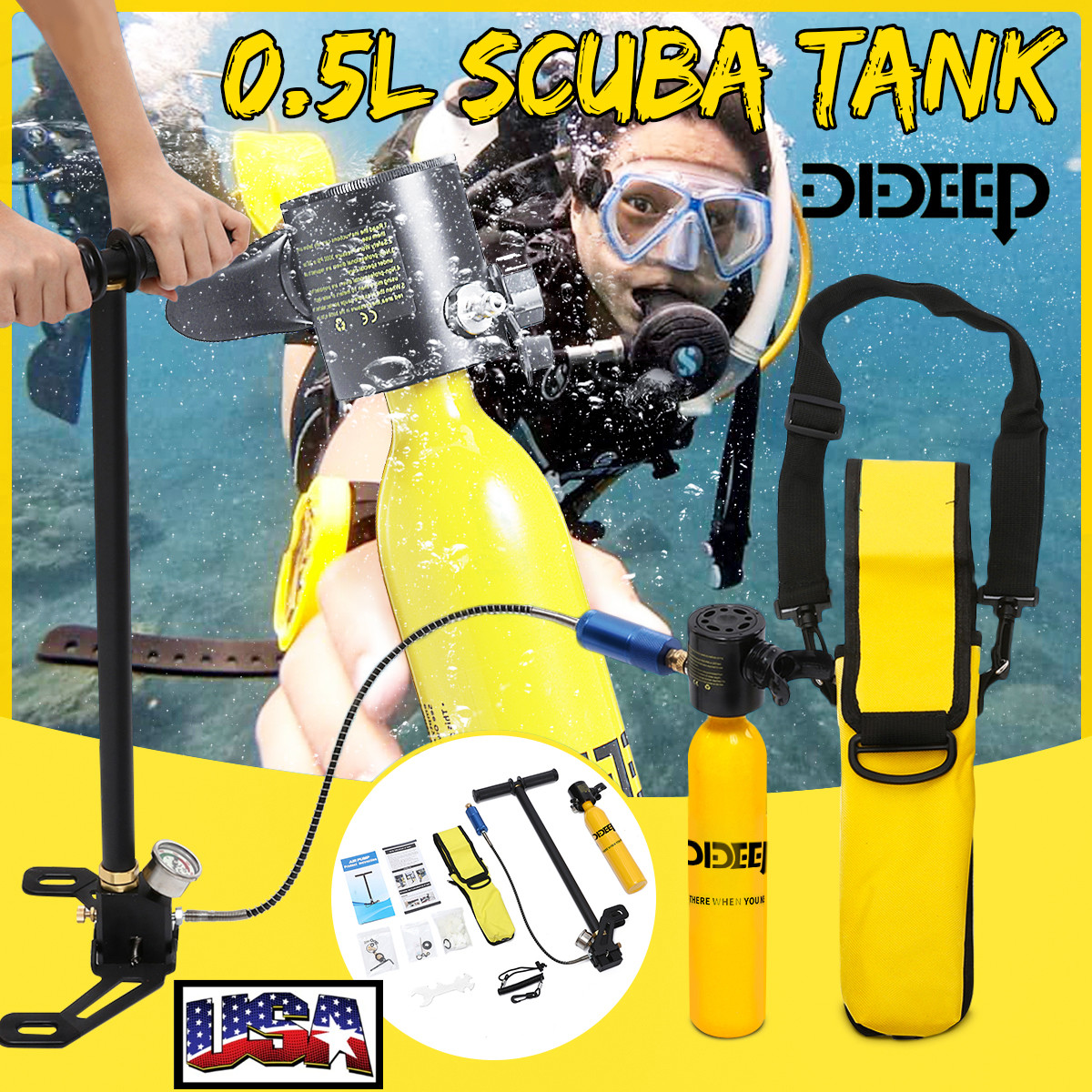

After a death in the AC, now all sailors carry small portable air
I just searched and am shocked how cheap these are
I really don't know anything about them, shelf life, etc but they start under $50
https://canary.contestimg.wish.com/api/webimage/5f51dc1cd34a7a0bbc78cace-large.jpg?cache_buster=8028906caddd60fc278481ed3c9005b4
https://i5.walmartimages.com/asr/5e316a54-e648-4ee2-9a2e-8425dea8a6c2.7a7cd9fde83eec65e5155a5c8f001bfc.jpeg?odnWidth=undefined&odnHeight=undefined&odnBg=ffffff
these don't look very practical and i know the units the AC guys wear is much smaller -
If you sail and trap out - a few $100 for a good one could be an option

When I worked at Sikorsky we had to do dunker training every couple of years to be on the cleared to fly list. Part of the training was to use those little scuba bottles. The trick is when you use them, you get a gallon of water in your sinus cavity unless you are right side up. You can still breathe, but in an emergency you don't get to choose what your attitude will be. For training they had us hook our legs on the side of the pool, and immediately go upside down against the pool wall. Then you get used to the water in your sinuses and can breathe. I think that is a key thing to experience so you can actually use the bottle in an emergency.
Also, interestingly enough, the key benefit of the bottle was touted as a tonic against panic. Pretty much all the escapes we practiced could be done without the bottle - unless you panicked.

The DigiDeep, Spare Air and similar emergency breathing apparatus typically have to be maintained the same way SCUBA gear does - meaning annual servicing and pressure tank inspections. Also, many of these designs have to be held while being used, leaving you with only one free hand.
They have their place, but I wonder whether other measures make more sense for the average sailor.

I'd also agree. I think with proper training they are fine, but otherwise could be a distraction when you need to focus on getting yourself free.
In training, and as issued from the flight equipment office, we always had a vest to hold the bottle. The hose was held in place with velcro and you would grab the mouthpiece and stretch it out to arms length, and then put it in your mouth. If it is not secured to your PFD or something it would not be practical.
