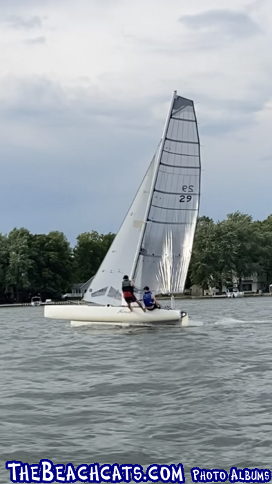

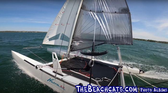

Leech tension isn't a good way to describe my issue. This picture is worth a thousand words... you can see the sail folds over when the "outhaul" is brought on. Look at the W shape of the batten at the first reef point. It really is a grotesque sight, much worse in real life.

i'm not familiar with boomlets, so I hope the collective will correct me if wrong. My conventional battens are longer and allow me to stretch the sail from the leech to the luff by using a batten-end and cord. To this old-time beach cat pilot, it just looks like these battens are too short.
Kevin, please add an image of the whole sail, the one you show does not look so nice.

Revintage, I will resort to buying a stick of alum if it comes to that. Below another picture. clear to see the bottom half of the sail has 2 distinct concave sections to it.

Kevin, the image tells it all, you need an outhaul(if the battens are correctly tensioned. So begin with to follow tominpa´s suggestion about the two lowest battens. Maybe you could also choose a stiffer bottom batten?
If going for boom you will need to recut the main and remove the forward flap under the lowest batten. No big operation. As you now have a square top with higher CoE than the original, it will probably be a good solution to loose the few cutaway square inches.

I don't think this is a boomless issue, from a previous sailmaker POV, it's a sail design issue. Building a boomless main had challenges. I had raced a 6.0NA with a square top and it took me a couple of rounds to get the shape correct. I would suggest take pictures up the sail at about mid draft in every 5 knots of wind. Watch when the sail "flips inside out". My guess, it is about 8-10 knots of wind.
But, it would be worth trying a boom and see if you like it. On my modified 18-2, I am using a section of aluminum hand rail for decking. It's about 3"x1". And 10' sections are easily to get. I wouldn't invest a lot into it until you are satisfied with the result.
