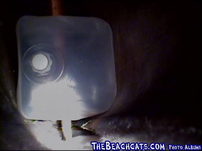

I know that my old 5.8 has Styrofoam blocks in the hulls to keep the boat from completely sinking. The newer 5.8 has plastic air bags in the hulls. There are photos in the technical section of this forum that show the Styrofoam in Hobie 14s & 16s.
You probably could not sail very well with one hull full of water. You might be able to keep the boat upright, which would help with rescue. Hope I never have to find out. Next time I sail in fresh water, I"ll pull a plug at the ramp and see how low it sinks.
In side a Hobie 16
edited by: skarr1, Oct 19, 2009 - 07:27 PM

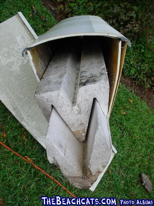

check out this amazing piece of foam in my mystere (actually in a friends)... this is incase you happen to have a pet flea or pet rock with you that needs saving.
Posted : October 20, 2009 4:13 am

Factory Nacra flotation inside a 5.8
Posted : October 22, 2009 12:26 pm
