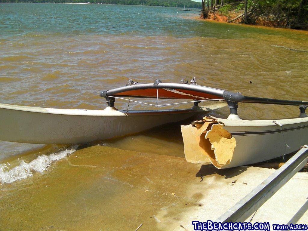

I just bought a 16 with this old style traveler, i'm sure i didn't rig it right (i'm used to the car style traveler.)
looks like you just feed a line through the simple metal cleat and tie it off on one of the small holes on the side, for each side. correct? am i missing something?
Bought the boat for 1$! had enough parts to rig it, sailed it. best dollar i ever spent.
also, one of the hulls is soft in the middle under the tramp. anybody ever had one fail catastrophically?

Yes, I have. Took a couple H-16's to La Paz about 25 years ago. Didn't know about the soft deck problem. Sold one and the guys called me a week later--the bow had broken off about 100 yards offshore. They were able to get in and I gave them pair of good hulls next day. When you sheet in hard in even medium wind conditions, that load (400-500 lbs ?) goes up leach of mainsail, down the forestay & bridles and tries to pull bow up. With soft decks, you've lost one face of a triangle and bow just folds. Don't even think about sailing with a soft hull. Pete
Posted : September 7, 2015 5:49 am
It will probably sail fine, and then one day you will flip and end up standing there to right the boat at which point you will hear crunching, followed by a "glug, glug, glug" and then find yourself up to your waist in water with the mast laying horizontal on the water....
Yes, they can fail. Soft spots mean that the hull structure is compromised. It needs to be fixed or scrapped.
Posted : September 8, 2015 7:28 am

downsjn wrote: also, one of the hulls is soft in the middle under the tramp. anybody ever had one fail catastrophically?
It does happen and can be dangerous.
