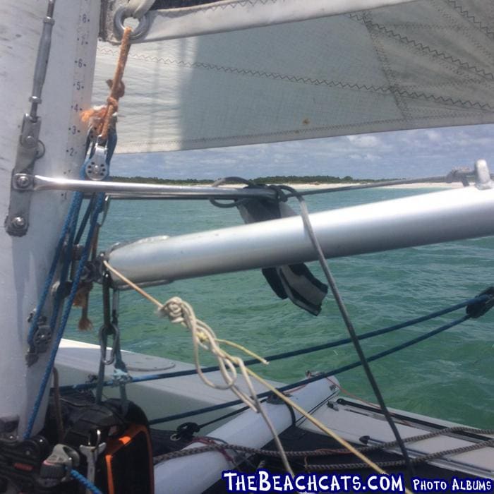

Can anyone provide some guidance on rigging my cat ?
In the attached image the circled white cable in blue is what I *thought* is the forestay, however once I raise the mast I am short connecting to the front bridles by about 6-9 inches. The sidestays are as loose as I can make them.
After doing some research, I can maybe use another stay adjuster to connect the jib to the front bridles, is that correct?
The previous owner sent me this picture, it seems they used the whole jib/furler assembly to as the forestay.
So is that 2 separate (but valid?) ways of rigging the cat? Either with the stay adjuster, or using the whole furler assembly?

This is an odd ball 5.2. The jib sheets to the main beam. The lower tang on the mast should not be for the forestay, they all shackle to the same location to aid in mast rotation. I did not see the upper swivel in the pics for the furling. The swivel plus the furler would give you the length you need. Seems like a lot of shackles and carabiners in the previous owner pics. When you add a furler to a 5.2 you shorten the forestay 6". I am curious if the jib was cut from an overlap to a blade. I like the idea for clearing the tramp clutter.
So is that 2 separate (but valid?) ways of rigging the cat? Either with the stay adjuster, or using the whole furler assembly?Edited by canadian_catamaran on Aug 26, 2022 - 08:51 AM.
Very familiar with old school Nacras. I would not trust the small tang the white forestay is attached to. All three stays, forestay and two side stays, should be shackled to the large tang. On the previous owner's picture of the "clip" between the furler and the forestay bridle; I would not trust that. You should use a bow shackle there. I am stumped why they would install a small tang under there forestay tang. I use the small one for trapeze attachment. With the forestay, there should be a top swivel, jib halyard block and a furling drum. This will add the distance you are missing. I know some 5.2's had jib sheet wires running fore and aft about 6-8" inboard of the hull. Is the jib sheet attached to those or the front beam?

I would get the standing rigging right first. The bridal to jib hardware is crap and is pieced together with parts out of the spare parts box.
Boats this old have long histories. The smaller tang could be for anything . . . I've seen them use for active jib downhauls on older rigs (before the jib furling). Hard to tell from his picture sent but he looks like he has a sheet connected to it (white with blue tracers) ending in what looks like a jamb cleat.
Nice boat and it has nice bones. You will love it once you spend a season sailing it.
Posted : August 26, 2022 4:55 am
(@pm)
Posts: 3376
Schit, I see it now, this boat was once rigged for spin. The bow spin bridle holes and the spin pole bracket on the front beam give it away. The ropes on the bridal are to hold up the spin pole. That small tang was probably used for retrievals or something McGyvered related to a spin.
Look up above the mast tang and see if there is another tang about 1/2 way up to the top of the mast, or if there are any rivot holes filled.

Hot damn! Raked spreaders. I have always wanted a boat this new. Since the jib has a cable inside it your forestay is only there to keep your mast up while stored. I prefer this instead of a zipper luff.

More pictures bring more questions. Things that I thought were strange
Don't know that any 5.2's had finished sterns, only the 6.0 had them, 5.5 and 5.8 were both unfinished.
Don't think the 5.2 originally had a main traveler track that went all the way to the ends of the beam early designs, 5.2 and original 5.8 did not. 5.5 and 6.0 did.
Don't think any of the 5.2's originally had swept spreaders many were converted.
Your main beam is rigged for an over rotator but your mast has a rotation limiter which is run off the boom.
No need for an over rotator on a boom boat.
Mighty fancy downhaul for a 5.2.
On to some rigging questions.
The pic with the blue circle looks like the forestay and the jib halyard may be reversed, forestay should be above the jib halyard, that's a huge block up there. Most old school nacra jib halyards are part wire and need a wire block, not one for line but your halyard may be all line.
Also the thimble that you're trying to connect to the bridle should be connected to the hounds and the aircraft swedge should be connected to the adjuster fork that is connected to the bridle wire with a pin and ring ding not a shackle, rigged like your shrouds.
Your bridle wires may be upside down also, the aircraft swedge should be connected at the bridle tang the thimble should be connected to adjuster fork with a twist shackle if memory serves me right.
There's a start.

You have everything for furling the jib. Installing the swivel & drum will take care of 6” you are “missing” on the forestay.
Someone swapped the rear beam, what you have is better than the original.
The jib halyard was originally part wire, part line. It went from a small wire block hung on the mast, (just below the main hound), down the mast - to where you cleated it after tensioning the jib.
Once you install the roller furling, you do not use that system. The factory Nacra halyard is zippered. Goes from the jib head up to a small turning block, then back down inside the jib, (parallel to the forestay), & exits at the bottom of the jib, just above the drum.
I installed a small Clam cleat there, I just pull the desired tension, cleat, & go sailing.

It seems like you have a Nacra "Pocket Rocket" 5.0 with 5.2 beams and rig, looks nice. The specifications say that the 5.0 is 5.1m long, exactly as yours.
Check the stainless wire inside the furled jib, it seems to be thin, multistrand and not usable as you have arranged it. To work as forestay, you need a 19strand 4mm wire, so get a proper forestay and attach it to the furler and swivel, after that mind about the jib arrangement.

To rig with items you have:
See if you can take the two top pressings of the bridle with the holes lining up on top of each other, set them in the slot in the lower end of the furler and put a pin through. Hopefully it works together with the old jib you have. If the multistrand wire is thick enough it could work for the time being. What thickness is it?
As Edchris pointed out, a modern jib is zippered and hoisted before each sailing session.

Just a couple brief points- don’t anyone hack on me, I’ve been up 36 hours & am currently on the Other Side of the World.
In the post above, 2nd from bottom photo- the boom less boAts are self rotating, that is NOT your case. See the “wishbone”, sitting just be,on your boom? You require a line from the end of that wishbone to the boom, to control mast rotation, otherwise the mast WILL over rotate. Going to weather, with mast fully rotated will not provide an smooth entry for the wind over the sail. It’s a simple short line, that will cleat somewhere on the boom. It will be at least a 2:1, dead end the line in the cleat, go through the end of the rotator, then back to the clamcleat where you will secure it. Less rotation going to weather, more when down wind. Not sure if I have a phot of it on my H18.
4th phot from the bottom - ditch the two shackles you have on the bridal wires, they serve no purpose. Simply attach the bridals directly to the U shackle on the bottom of the drum. I would replace that one with a bow shackle, they are designed specifically to hold the horizontal loads, the shackle you have is designed for vertical loads.
Regarding the mast pin- REMOVE IT after you have stepped the mast. It’s so,e purpose is to hold the mast captive, so it doesn’t jump off the ball while raising or lowering the mast.
Also, look closely at these two photos. Notice that with the pin installed, you WILL bend your DS rod if you lower the mast & forgot to keep it ROTATED 90* while lowering. Sharp eyed folks will also notice my dumbass mistake…I didn’t have the pin handy, used a 1/4” bolt, BUT, I rotated the mast the wrong way, & could not remove the bolt without lifting the mast again. In this case, end of season, I used bolt cutters…think about the orientation of the pin, & if you use something long, like a screwdriver, be careful it doesn’t rip the tramp.
Ignore the rotator in my photo, on a boom less boat it goes forward, yours will be toward the stern.

You seem to have a lot of hardware at the mainsail down haul. Some may be for adjusting sail tension while underway, & from either side of the biat. You are just starting out, endorse the KISS principle. Just use a simple block arrangement, with an “S” hook. Simply drop the S into the sail cringle, pull line to desired tension & go sailing.

Question 2Should my wishbone be mounted above the boom as opposed to below? There is nothing except the cleat at the top of the boom where I tried to mount it with the red rope, but not very well. More guidance on how to do this would be welcome. I've tried looking at a few youtube videos of people sailing the boat and noticed the wishbone was above the boom.

2 The mast rotator(wishbone) must be over the boom and used together with the camcleat and the stainless bracket to adjust rotation. Simple and straight forward: Attach the red line close to the clamcleat go through the bracket to a single block attached to the rotator and back the same way to the clamcleat.
At the same time you have to fix the downhaul so that you have 4 parts and two blocks on each side of the boom and get rid of the messy shackles. A simple line loop through the tack with the two joined blocks on each side is all that is needed.

As seen in your image you don´t seem to have been able to use the downhaul at all. Probably you should also add some prebend with help of the diamonds and spreaders.
