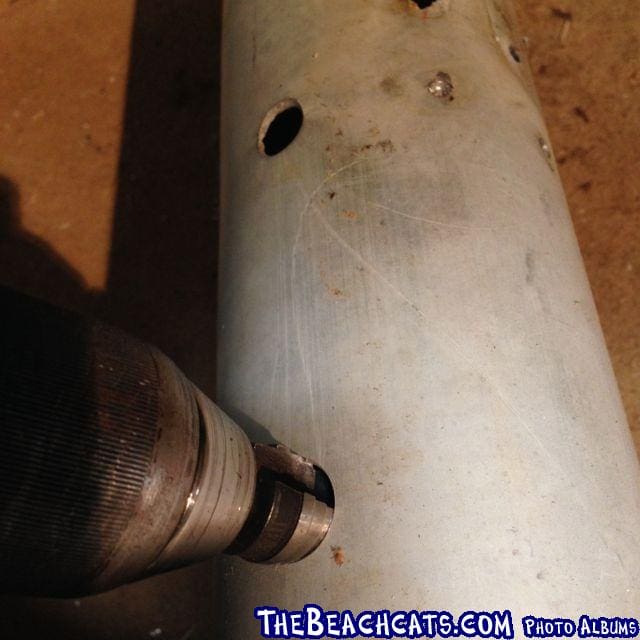

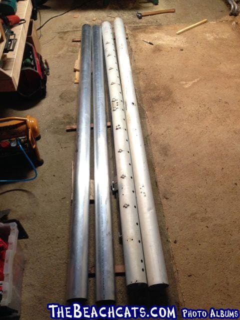

So the big news/update is: I took a deep breath and a fresh beer, and went to work drilling out all the old rivets to remove the fittings from the old beams. I was expecting to go slow, use lots of cutting oil, and probably wreck a few drill bits on the many stainless steel or Monel rivets. BUT, the first rivet drilled like butter… what the??? And I quickly realized EVERY SINGLE RIVET on the old beams were aluminum. Unbelievable. No wonder every fitting was loose and wobbly. But no matter, someone else's crappy work meant I was drilling out each rivet in 4 or 5 seconds. I am just hoping that the rivets on all the mast fittings are not aluminum too - this would be a disaster waiting to happen. Aluminum just isn't appropriate for high stress fittings on a boat. I shall investigate and replace them all if necessary.
Not only that, but I found things like the traveller cleat rotator plate was riveted with looooooong aluminum :-O rivets that didn't make it all the way through the casting so they could pull/mushroom properly. Essentially just a little friction from a very soft metal in the sidewalls of the hole. Oh dear. I can't believe half their fittings didn't rip off the boat.
The old beams are now stripped, and the new beam tube is cut to length and ready for assembly. I'm experimenting on a piece of beam tube off cut with x-fine grit wet/dry sandpaper. Since I'm not gutting anodizing done, the new beam tubing is quite shiny, and I want to dull it down a bit so it doesn't look odd, or show up scuffs and scratches too easily.
Questions: Should I through-bolt the traveller cleat on to the casting, rather than try to rivet? (It really looks to thick to rivet, as the previous owner must have found out).
Also, do I have any options attaching my old traveller track to my new beam, besides drilling a bunch of huge holes to fit a socket through to nuts on each screw?
I've got several of them, from old 5.2's, I think they are all riveted. I think it was just aluminum rivets to hold the casting to the rear beam, I remember they drilled off easy. The bullseye used machine crews to secure it to the fitting. SS bolts would be easy, but you have to make sure the bolt heads don't interfere with the swivel mechanism, IIRC there is not much clearance. I', going up to the lakehouse tomorrow, I'll see what's in the bin, I might be able to send you an entire package.
It will loose much of that shine quickly, with exposure to the elements.
Myself, I would suck it up & start drilling. Those old tracks are fairly high profile, the rivets would need to be close to 1" long. I think you also need countersunk heads that will end up flush with the track.
There is quite a bit of stress on the track, though it is spread out over a bunch of fittings. If you did go aluminum rivets, I think a backing washer would be in order. You will need to keep everything in alignment. I would fit the track, then wrap tape to keep it in place, then mark or drill pilot holes, from the track through to bottom of beam. Then drill out the bottom holes, that way everything will line up. The machine screws will be pretty small diameter, you can use a 1/4" drive, or even a nut driver handle with small socket, so the final holes won't be that large. Support the beam rightside up, so you can install nuts/lockwashers(or use blue Loctite) from the bottom, that way they won't fall off...it will be a 15 minute job. Just stick a bit of gum/plasticine etc into the socket so it holds the nut/washer just flush with socket edge.
You will probably need fasteners with countersunk heads, I can't remember how much clearance there is from track to car on those old setups.
In my opinion, every rivet should be stainless or monel, unless through a very light duty fitting. Can't speak for what you've come across. I will be using all stainless 3/16 rivets on all my fittings. I've used aluminum for other non boat projects - they are very soft and weak.
No issues with time spent drilling - the 6061 cuts like butter with a good bit, especially step drills for the large access holes needed for a socket head. (Step drill bits are AWESOME!) I just keep pondering the sag in the old beam, and the amount of material taken out from the underside of the rear beam with all those 1/2-3/4in access holes. Structurally, I don't like it. Swiss cheese. But if that's the standard way, so be it. My beam tube is 50% thicker (0.125") so I shouldn't be concerned. They probably had some sort of accident to put the bow in the old rear beam anyway. I keep hearing rumors of previous owner's run-in with heavy snow pack one year, so that could explain a lot of things.

BTW, I have a method of lining up through-holes on large diameter tube like a beam. Take a punch and make a dot. Get a flexible flat tape, and measure the circumference around and back to the dot. Divide that number by two, and measure that amount and make a another dot (e.g. 9in circumference, make a dot at 4.5). Drill each dot independently. Done - no need for a drill press. Did I mention how awesome step drill bits are? They also slightly
self-bevel the rough edges of the hole.
It isn't a problem, all the Nacra's were built that way,& I've never heard of beam failure. Think about aircraft construction, the webs in a wing are so full of holes there is more hole than material. It's all about where the holes are in relation to the load.
If the holes were in the side, it would weaken the beam. If the beam is subject to vertical bending loads, the bottom is either being compressed or pulled apart. Either way the remaining material is stronger than the rest of the boat.
