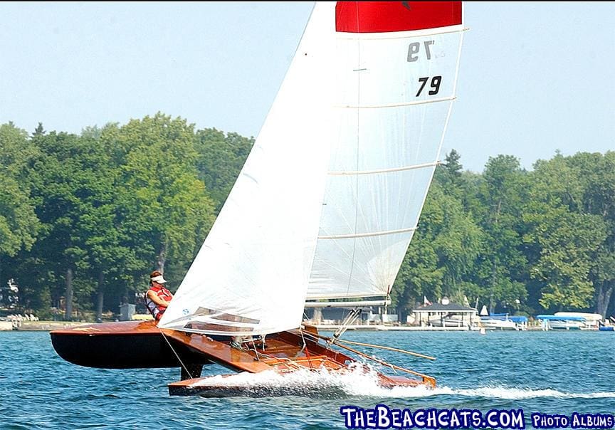

In case anyone isn't sure what a Shark Catamaran looks like, here is a picture of a Shark Catamaran.

FYI- that is me and my wife in the Shark picture up above.
