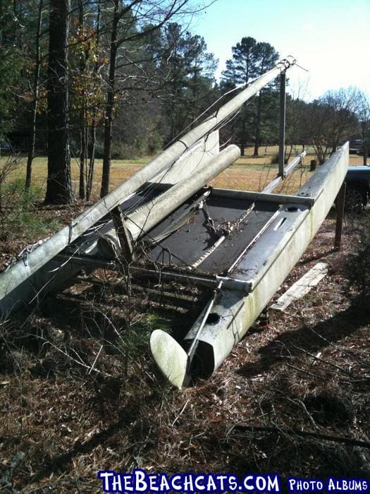

From this
To this:

the old 5.2's do scrub up well don't they
from this
to this

Great to see these boats get a new life.

Wow eric. Good to see another transformation. I may ask you some rigging questions concerning the down haul at the base of the mast etc. Do you have pics of this area of your boat?
Have not sailed her yet. A few things left on the list to do.
