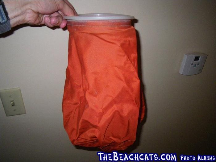

Posts: 4071
Here's the cat bags that fit into the ports and rest on the lip built in to the port.

I just got a prindle 18-2 and am looking for a very specific model hatch with a flip up handle. I could use a standard one like pictured above but was hopeing for a fancy handle to make opening a lot easier
