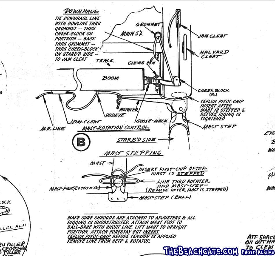

Posts: 4071
kraven wrote: I use a 12" piece of bungie cord and tie a square knot with the knot and slack forward of the mast step. This way if the mast slides off the ball the bungie will catch on the ball and keep it from going too far.
Hate to contradict an G-Cat owner on how to do this because obviously it's worked for you.
But for other G-Cat newbies maybe reading this, the instructions call for line and not bungee, makes sense since line would hold a knot better and control the movement better.
Assembly Manual Download
http://www.thebeachcats.com/pictures/?g2_itemId=86558
Piece of the assembly diagram.
All the G-Cat scans are here
http://www.thebeachcats.com/pictures/?g2_itemId=80914
Posted : June 18, 2012 4:43 am

Damon, what the diagram does not show is that when the mast is laying across the tramp, you cannot drop the mast base onto the ball, the rotator arm hits the beam, you have to have the mast at about a 30-35 degree angle before the rotator clears the beam, only then will the mast base drop onto the ball. I built a tripod using 2" PVC that I use to rest the mast head on, while the mast base butts up against the beam with the rotator arm pointing down through a cutout in the tramp sepcifically designed to accommodate the rotator. This gives me that angle, then I walk around to the mast base, lift it onto mast step ball, line up holes and pin with a phillips screwdriver, step the mast, remove pin, and attach forestay.

Thanks for the info. I didn't realize bungie was so fragile. I just had it handy because I use it to secure the shroud and trap wires to the mast during transit. I'll use line instead next time.
