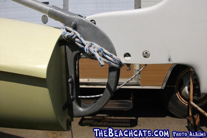

i use nitrodubs method...i drive 70 miles each way to the coast with my p-16
Posted : October 10, 2010 10:06 am
(@coastrat)
Posts: 1292
here is how i secure the mast/tiller crossbar...

Thanks for the pics coastrat, appreciate the time spent posting those up on the website, I like that mast holder. 😎
