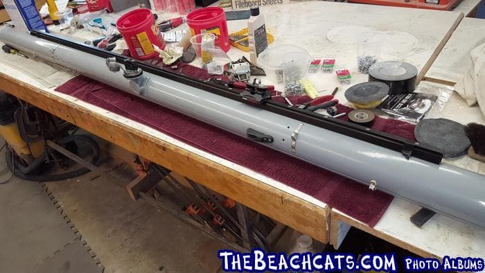

My 5.2 had a a aluminum tube connecting the front cross tube and the stern cross tube. It ran above the trampoline. We would slide our full size canoe paddle under it and it was tight enough to stay put. None of the others I've seen have had that, which has made me think it was a very early model.

All 5.2s up to about 1984 had that to keep the front beam from rotating by force from the mast. Most people removed it and rivetted the beam to the straps to do the same thing. After 1984 the centre beam was replaced by a castings inside the beam and an additional bolt into each hull.

Here is the beauty of removing the center tube. You can also eliminate the tube casting on the main beam and then also with some effort cut the tube section off the traveler cam assembly. Then you don't have anything to tear your knees up when you go sliding across the deck into the water.
