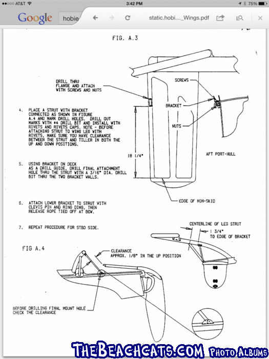

Now, it appears that the struts were never installed and are probably long gone. The install instructions (below) call for the rear struts and now I am wondering if I might break off the wings if I don't come up with some supports. Of course, there is no evidence that they were ever installed, and they ain't broke yet! (I meant to do that.)

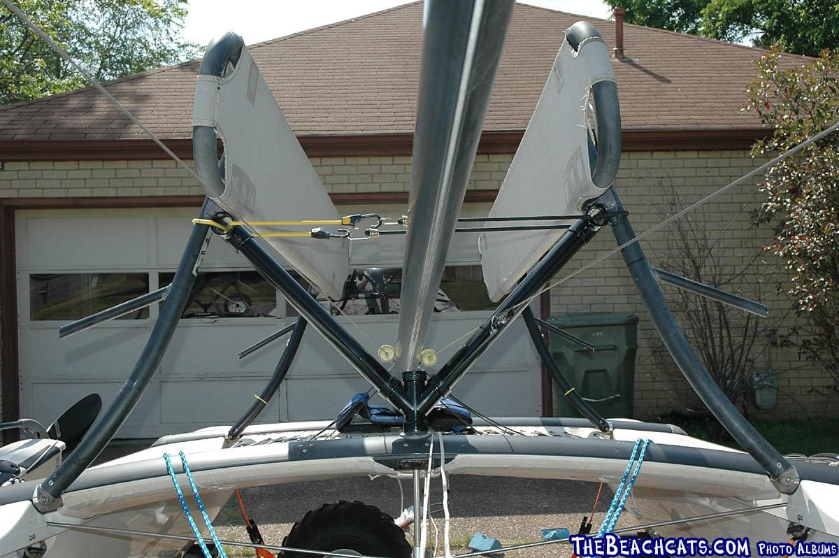

Speaking of the wings, how are yours supported for trailering? If they are just strapped down to the mast you get a lot of rubbing and damage over time.
Need some version of this.
http://thebeachcats.com/pictures/?g2_itemId=11711

Yes, you need the struts... they don't really support weight, but prevent those long wings from shiting for and aft and thereby prevent stressing the other joints in ways they weren't designed for....
Figure out how to get the mounting plates, and just get some alu rod material and drill holes to insert the pins through the rods and into the mounting brackets....
And yes, you really should have those mounting plates on your crossbars too... someone retro-fitted your wings and didn't pass along all the original hardware....
Install and removal of wings and all parts is not trivial... involves basically disassembling the boat, and removal of a crossbar end casting to get the slugs out.
Finally, I'd make sure in your hulls there are extra layers of fiberglass, about 12 inch by 12 inch, in the inboard and outboard of each hull where the crossbars meet... Hobie beefed these up to help handle the extra concentrated stress and load pressing down into the hulll at those points from wings...
that said, I'm sure plenty of folks keep going like you are and may be just fine. your boat, your call.
cheers and congrats again on the awesome Hobie 18!

given the number of items you are missing for correctly installing the SX wings you might be better off biting the bullet and purchasing the SX wing mounting kit item number 68060101 which I last saw at (if I remember correctly) West Coast Sailing. It runs about $290 and may include a few things that you may not need such as lacing line but at least you will know you have everything you need plus instructions. I helped a friend install used SX wings on his cat last year using that kit. PS: you will need a very heavy duty riveter to properly seat the rivets in the wing anchor plates and the strut mounting tab that goes on the rear wing arm.

There are four stainless steel brackets that you need to mount to the rear wing arm and deck (two on each side) that the struts attach to...the struts are easy to make but the stainless brackets not so. (FYI, experience from owning 4 SX wing 18s over the last 30 years), get the right parts, don't cheat yourself.
