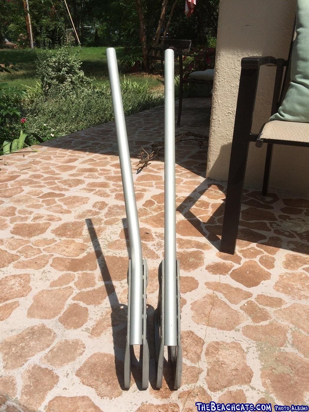

My 1983 Nacra 5.0 (recently purchased as a basket case) came with two different types of tiller tubes. One is straight and one has a bend in it that appears to be factory:
I hung the rudders today for the first time since getting the boat with the bend toward the center (opposite to my photo above). Checking rudder alignment, the leading edge was about an inch and a half wider than the trailing edge (i.e. toe out). This seems very extreme even if you are considering Ackermann angle.
The tiller tubes are both roughly 28" in length. The tie bar is 81-1/2" in length with the hiking stick attachment hole dead center at 40-3/4". The tie bar does not have the adjustable end cap.

You have a mismatched set. The 5.7 came with Ackerman angle tiller tubes.
Our '88 5.0 has straight tubes.
I would try to source one or the other, & hang a matched set.
If on a tight budget, just purchase an aluminum tube the same length & wall thickness as the straight tiller. Drill the rivets out of the Ackerman tiller, & rivet your new tube into the casting. The castings will be the same.
Someone here must have a tiller tube for sale.
Sell the Ackerman tube here, someone must have crashed & badly bent one.
Our 5.0 does not use an adjustable tie bar, the 5.7 came with it. Tie bars are not cheap. If you "hack it off", & screw up the measurement a bit, you are S.O.L.

I'm a symmetry fan myself. I felt certain something was not right when I first noticed that I had a mis-matched set of tiller handles. I'm planning to replace the dog leg handle with a straight one. Mocking that up with the 81-1/2" tie bar, the rudders are in nearly perfect alignment. The tubing they used for the tiller handle is odd ball, 1.000 OD, 0.083 wall. I have an extra, damaged tie bar (same tubing size as the tiller handles) that I'm going to repurpose and cut a striaght handle, 28" from it.

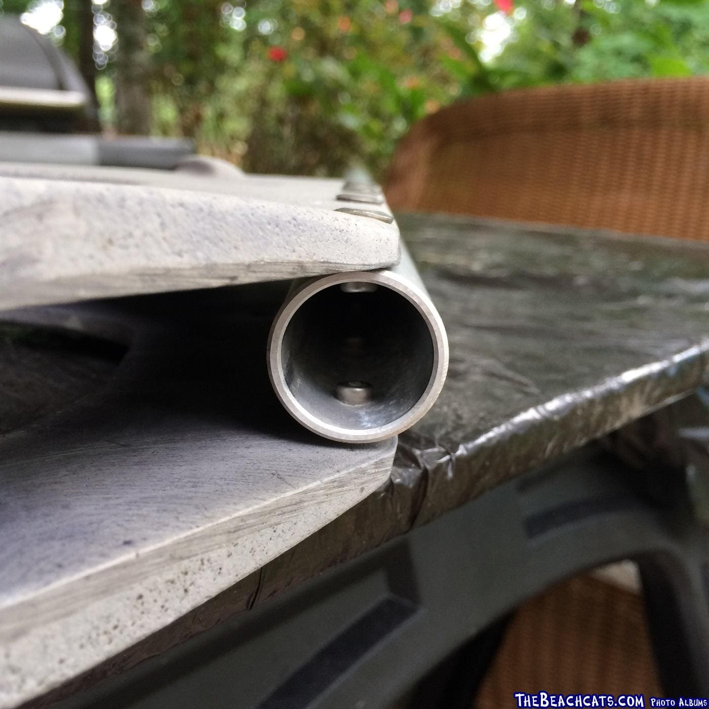

Thanks Ed for a great tip. I did indeed your advice on the radiusing and polishing. Those edges are very sharp.
Before:
After:
It's easy to see how the sharp edges could eat up bungees and lock down lines, not to mention being very hard on the sides of the rudder.
As I mentioned above, I'm going to replace the Ackermann tube with a straight one. I noticed that the cavity that the tube is installed in is about 1/16" wider than the tube and to accommodate this they used small washers:
They appear to be of a fiberous material. Can you or anyone verify the material, size and a source for replacements?
Maybe it's just the photo, but I see file lines in the metal. Take any piece of 240 grit sandpaper, just use your thumb & smooth tha tout, your bungees will luv you.
These do not exist on any Nacra tube I have, or have seen. If you are leary of compressing the tube, just go to Home Depot & get a plastic washer. It's a tricky thing, you want to be careful about bending those castings, BUT, you don't want any slop. Even a little, at each point in the system adds up.
