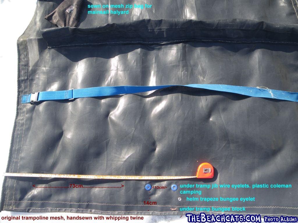

- the jib wires can go under the tramp if the saddles are also moved below but the wires will need to be slightly longer to do so, or use a high tech not-stretch line

- most people cut slots in the tramp to bring the wires up for the blocks with sewn on reinforcing, but i decided on plastic eyelets, you just have to be very sure of where you want the blocks to go
