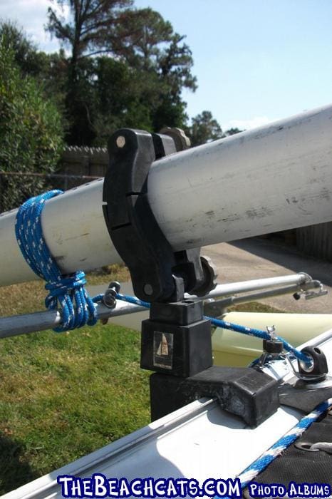

I just purchased a Prindle 18 and would like help naming or finding something to support the mast at the rear of the boat like this setup to prevent the mast from riding on the rudder control bar.
Thanks!

http://www.thebeachcats.com/forums/viewtopic/topic/11193/start/0
Rear Mast Support with "V" Stainless Steel
http://www.murrays.com/13-3002.html

this is a hobie 16 but i'm sure you could use the same approach
http://www.thebeachcats.com/pictures?g2_itemId=88398
