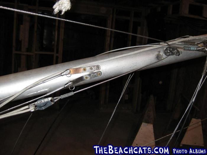

The setup, as shown in the manual, uses a wire that attaches via a shackle to the head of jib. It runs up the fore stay,(pulling the jib along with it), around the wire block that is attached to the mast, then down to the mast base. Understand that you need an additional length to allow the jib to be dropped, this length is made of thin line. After the jib is raised, this additional line can either be unhooked,(via a sister clip), or stored in the tramp pocket along with the main halyard. This line is attached to the top end of the wire, but the knot is not neat, it is tied with a tail left hanging...I think my 5.7 leaves about 1.5'.
Once you raise the jib you use the tail to tension it, & stow the main portion of the halyard. It would look like this;
The wire at the top of photo runs from the head of the jib,(travelling left to right) & is hauling the jib up the fore stay. It then goes around the wire block, & down the mast. Your 5.0 is rigged slightly different in that it only uses a 2:1 downhaul, therefore your rope line is attached directly to the wire line. (omit the block with becket you see in the photo). It is tied with a long tail. Once the jib is raised you run the tail through a jam cleat mounted on the mast. Pull the tail to tension the jib & cleat,(the block up at the mast hound gives you 2:1), stow the rest of the line in the tramp pocket.
My photo shows the 5.7, which uses a 3:1 downhaul. The only difference is the long tail is run from the becket down & through a cheek block at the bottom of the mast, back up through the block, then down to the jam cleat.
