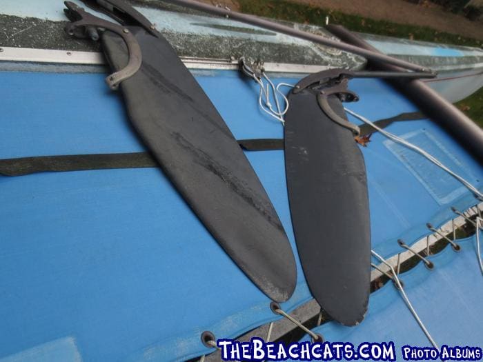

don't have much experience with Hobie rudders, & the manual said they changed them in '87, but, these appear to be a very stiff black blade. There is not a nick in them. There is a large plastic adjustment screw on the lower casting, & what appears to be some sort of black cam/plunger in the casting. I just saw this in passing, as we took them off & tossed them in the van.
Black blades are not stock.. that's good, if you had original ones, they would probably snap on ya just from age
plastic adjustment screw is to adjust when the rudders kick
i am pretty sure (unless they are customized) those are newer version castings (post 86) The older had a metal cam (not a plastic one). my h18 had to older one until i hit shallows ad cracked the casting. i purchased the upgrade kit. $700
http://www.murrays.com/50-60331010.html
just like your mystere's, lube that cam every sail. will make kicking up, and pulling up much easier and could save your transoms from damage if they don't kick on shallows
Edited by MN3 on Nov 04, 2015 - 10:01 AM.
Posted : November 4, 2015 4:01 am
They appear to be a fibreglass material, I can just make out some of the fibres in one spot that has a bit of wear. Condition wise they are about 9.8/10, there are not even any scratches on them
They definitely have the black plastic cams.

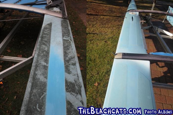

I took a rubber block & 400 grit wet/dry & gave it a 30 second rub. It completely changed from whitish, to a sky blue, almost the same color as the tramp.
100 sheets of automotive paper, & a couple days work, it should cleanup very nice.

If the blades are black with fibers showing, then they are likely original EPO rudders. A stock upgrade from the standard lexan blades. If they sat out in the sun for many years, the fibers will start to become exposed. You will definitely want to sand off any loose fibers and re-coat them with epoxy and/or paint to seal them back up. Otherwise, they are very good rudders.

Got the album to work.
http://www.thebeachcats.com/pictures?g2_itemId=120185
It's pretty grungy on the hulls, but I think it will clean up nicely. I took a rubber block & 400 grit wet/dry to a few spots. They came out pretty nice, it's not actually a white boat!
I appreciate all the suggestions, & anything else people might notice from the photos. I would sooner do pre-emptive work, based on others experience, rather than reinvent the wheel.
If you go to the album & select max size, you can just see what looks like fibres.

The rudders look like EPOs. You can clean them up with a little elbow grease and some relatively inexpensive materials. A quick overview of the process I've used - knock off loose fibers and scuff up the surface using 150 - 220 grit paper. Paint on a coat of epoxy resin (one side at a time). Sand down to a dull finish. Recoat with epoxy and repeat if necessary. Shoot with two coats of flat black spray paint. Wet sand up to 1500 grit.
Your boat also has the upgraded rudder castings.

as for cleaning rent a power washer. it'll be looking brand new real fast. be wary of power washing any soft spots on the hulls to powerfully. strip the tramps off, all of the lines, and power wash those too.
I soaked all lines in a bucket of hot water & oxyclean overnight, then threw them in the wash, on HOT, again with more Oxyclean. Despite knowing better,(and not being able to locate the wife's' bra bags)I just tossed them in. They came out looking nearly new, but, looked like hangman's noose & spaghetti thrown against a wall. Took 1/2 hour to untangle.
I went over every inch of the hulls yesterday, there are zero soft spots. The high load/wear areas are all solid, probably due to no hard sailing. The lake it lived on since new is tiny,down in a hollow, it would never see waves/swells. I also confirmed it is not a "redline", the glue is black.
I have a gas washer, so went at it for over 3 hours yesterday. The tramps came out looking new. Took all the algae & dirt off the mesh & hiking straps. I don't think they are original, they are in to good of condition.
The boat took quite a bit of time. The worst is the non slip. Every small ridge blocks the spray, & leaves a very fine line of grunge. You have to go at it from all 4 directions to get it completely clean.
I also recommend a mechanics stool, with wheels. You need to be able to move along the hull, & precisely control the power wand, or you will eat the speed lines. By holding the wand a few inches from the end, you can strip within an 1/8" of the lines.
The boat came out looking very nice, though it left a stream of blue/white water running onto the lawn. Maybe the chinch bugs will eat it & die!
I was going to order a quart of heavy compounding solution, but I think 70% of the oxidation stripped off with the washer. I'm going to go with light compound/polish in the spring.
Added full size photos to the album.
What I thought was black anti skid is actually just grunge
Hulls totally cleaned. The tramps are hanging in the background, on the lightpole to dry.
For its age, the boat is fairly free of dings & dents.
Now parked in the backyard for the winter. I know it's not ideal, the trees are oaks, they don't tend to come down in storms.
