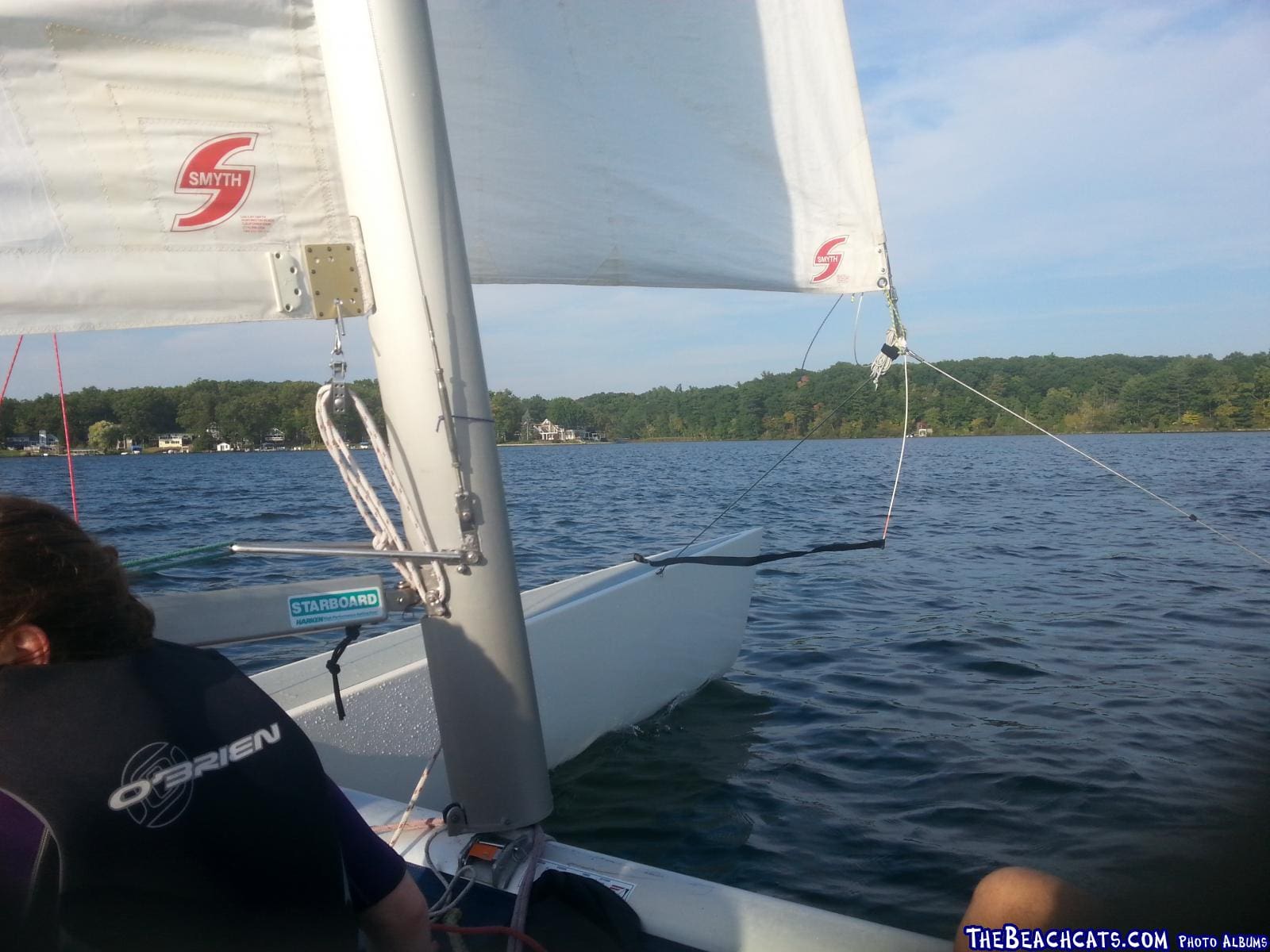

So, got caught in some violent winds witch were not predicted, capsized 4 times.
The 4th time I was so tired, I could right the cat but couldn't get back onboard. After 10 min hanging at the righting-line and several attempts to get aboard, I decided to fire a smoke-signal wich is always in my life-vest.
Watertemp was 10degr C and Airtemp 11degr C .
Was rescued by a friendly skipper who even gave me a tow back to the cat-beach.
An elderly skipper at the cat-club (67), showed me his setup how to climb on board.
He tied a 12 mm line to the front crossbar hull to hull, the slack on the line is just deep enough in the
water to put a knee or foot on it , while you're in the water.
When you try to climb onboard this line will go under the tramp and is not very helpful.
Now here's the smart-part, he braided another line to center of the boarding-line, ran it through a block
attached in the center of the bridle for the forstay. Tied a stopper-knot behind the block to prevent the
boarding-line from going under the tramp.
The stopperline is braided to a shock-cord witch is ran under the tramp, it keeps the whole setup out of
the water while sailing.
Here's a drawing,
Fiddled a bit with line-lenght on my P18-2, and now it works perfect and makes my wintersailing-project
a lot safer.
If somebody is interested, will post some pics.
Regards, André

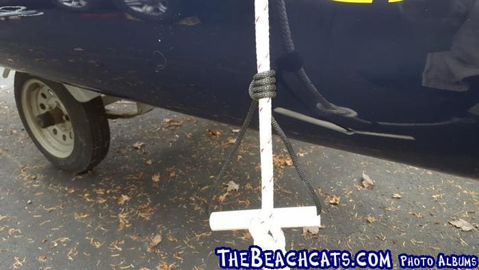

I needed to replace my righting line. Looked around for appropriate size line and found it more than $1 per foot. Went to West Marine and found a 25 foot nylon double braid line with a 12" eye splice in one end, cheap with a coupon.
Back on the cat, I tied three half-grapevine knots on the line, spaced to be used during righting, and set the overal length so that the eye splice was just in the water when the cat is on its side. My foot goes in the loop and I use the knots to pull myself up, and the hull over. Car manufacturers and stereo installers use a coiled plastic wrap to manage lots of wires together into a bundle. I used 4" of that same stuff to hold the eye splice open into a step. Otherwise the loop just closes when wet.
Usually my crew is on the bottom hull as the top one comes down, and so climbs to the deck of the hull as it rotates. If he gets left in the water between the hulls, I wrap the righting line around the mast base a few times and drop the foot loop in the water for him to use to climb back onboard.
If you can make your own line, you could incorproate a curved piece of PVC or electrical pipe to form the foot loop, just make sure it is small enough to fit into your tramp pocket.

catmodding wrote: Guys, made some pics and a video, yes it is crappy, but it is a life saver!!
There is a elegance to the simplicity of your solution.
I like it!
Posted : December 13, 2012 6:41 am

The issue is not having enough upper body strength to pull yourself up onto the wings or a deck.
André's solution gets your butt high enough- using your legs- to simply slide over onto the deck.
I have been that tired, and had to pull tired crew up many times as well.
Awesome solution, André!
