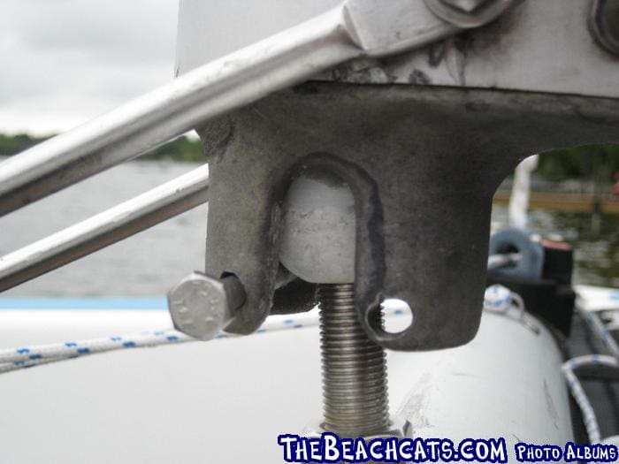

Turbo...I'm thinking the same as some others. On the Nacra the "captive base" is only captive while stepping or unstepping the mast. The manual says to put the pin in before raising, then,
"Remove the mast step pin to allow the mast to rotate freely while sailing"
The only thing that keeps the stick in place is rig tension.
I believe G Camicks album has a good photo of a non captive base.
Here is the captive base of my 5.7 after stepping, with pin (bolt actually, the pin is somewhere in the lawn) in place. You can see that if the mast falls anywhere except exactly sideways, the mast base will hang up on the DS rod & bend it, along with other damage. Only by turning the mast so the base slot lines up with the DS rod can the stick be safely lowered.
There is no danger to leaving the pin in place...as long as your mast NEVER comes down 😉

Ed, Thanks for the picture! I was trying to dig one up myself to illustrate my respnse to Turbo. I didn't mean to say his post was wrong and if it came off that way I sincerely apologize. I have seen Prindles with the above setup and I think some were retro'ed. I can't explain the back hole on your mast base, my bases have just the single hole in front. Didn't you and I talk about that some time ago? As an example of what can happen...one day at the beach a couple fellows were loading their cat on the trailer. To lower the mast, the guy in front pulled the pin on the forestay, and as the guy on the tramp stepped back to the rear crossbeam the boat overcentered on the back rollers. They had forgotten to strap down the hulls. Anyway, as the front started to rise, the guy on the back toppled off the boat, hulls came down, the mast came crashing down and bent the heck out of the DS rod. The mast got dented on the traveler track, mast base was cracked and it was bound so tightly that despite the twisting, turning and raising the mast it took a hacksaw to free it. A mast coming down out on the water probably wouldn't be as violent but would still suck. The pin I use is a 1/4 x 2 1/4 with a ring-ding on one end and here's another spot to pay attention. Several times I have lowered the mast only to find the ring-ding between the mast base and tramp. DUH! So, back up goes the mast along with much cursing, to rotate it so the pin can be pulled. Another free tip! It's better to unstep the mast BEFORE the Bud Light!
