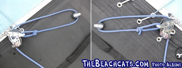

Yes two lines, but they are one continuous line or the ends tied together. One end works the traveler, and the other the sheet. Think of the sheet as fine adjustment and the traveler as course. Traveler centered up wind and out at the hiking straps downwind.

There should be an eyestrap on the rear beam, center. For the 5.0 just tie a stopper knot at one end of traveller line. Pull free end through pad eye til it stops at padeye. Feed free end through the traveler car & tie off to end of main sheet. (Before you tie it off, run the traveler out to the end of track, & tie another knot in traveler line so that the car cannot quite go to the end under load).
If you don't use this second stopper knot, you risk the car slamming into the end of the track. It WILL shear off that little plastic piece at the end, & the car & all the bearings will go into the drink. You will get the car back, as it's captive on the line, but your bearings will be gone.
When solo & the winds up, I always hang the business end of the traveler line over the hull, just at the rear beam. If you are getting way overpowered it is easy, even from the wire, to do a knee bend, grab the line & let the traveler out.

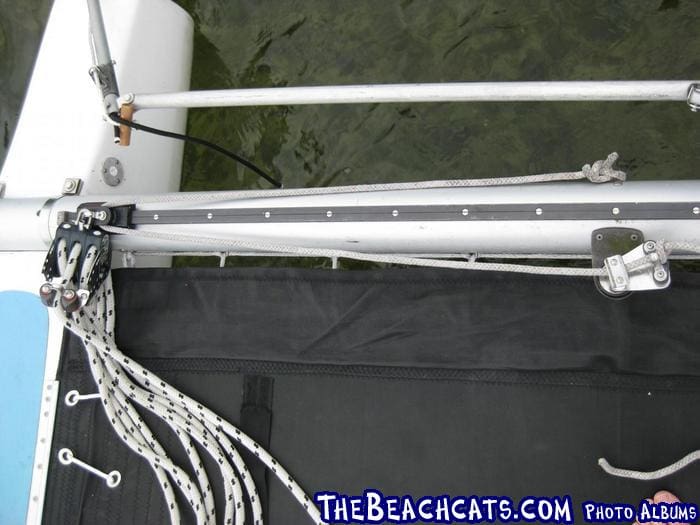

Make it look like this.
Posted : April 11, 2015 11:38 am

the picture looking down on the traveler is how mine was after i upgraded to a better traveler car. the 1983 model had a 4 roller ronstan traveler car with the cam cleat for the traveler on the traveler car. Concept about knots is the same (though the end stops on the ronstan were beefier) but if the picture does not match it is because you have an earlier model. if you do, you might be able to find the parts to upgrade to teh set-up above with a 6 roller ronstan car which will handle the load better.
Posted : April 11, 2015 2:31 pm
(@Anonymous 29074)
Posts: 29
also in the picture above tie the tail of the traveler control line in teh bottom right to the tail of the mainsheet and make sure they are different colors. one is fatter than the other so use a sheet bend.
Posted : April 11, 2015 2:34 pm
